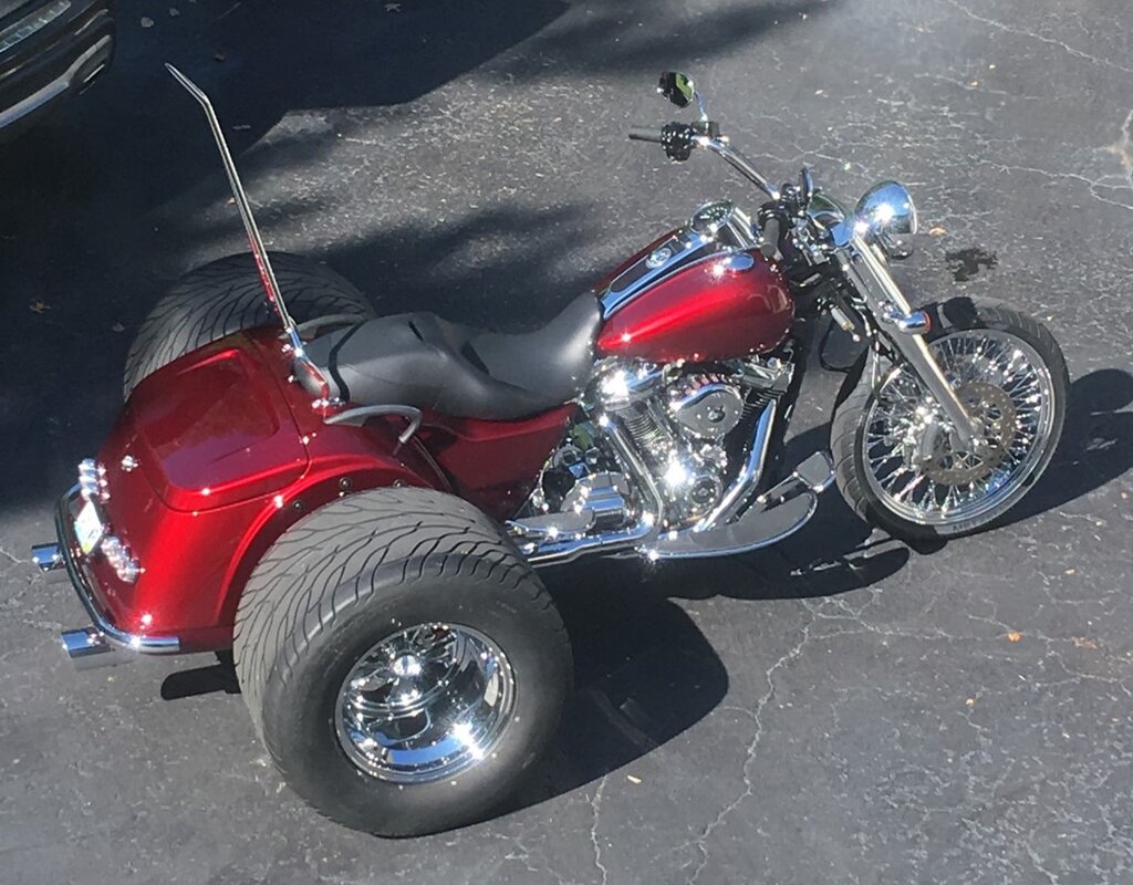

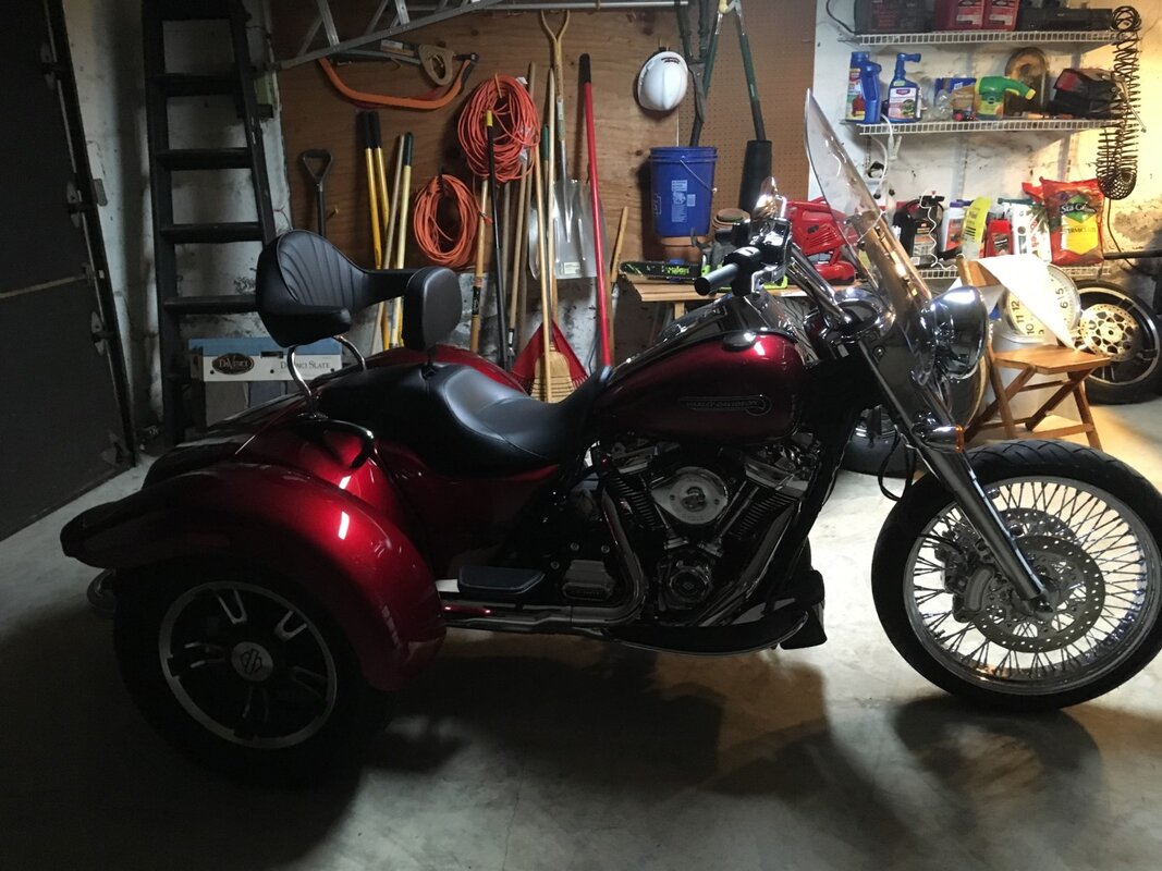

Did that Ginz slip right into the stock sissybar mount? And does it sit farther back than stock? I have a Corbin, and my ol' lady has a crotch full of backrest. My seat is back a couple inches from stock, and she's kinda crushed.
Yes. You send them the HD sissy bar and they modify it. It is jigged/tooled well as it plugged right in. It does not sit back further than stock though. You would need to talk to them about how best to do that. I had them make a top to bottom sissy bar pad as well. I have thought about making a seat pan with a King and Queen arrangement.... but that will be a much later chapter in this build.
Thanks, appreciate it. Just trying to make things more comfortable for her lap, and for my ears :cool:

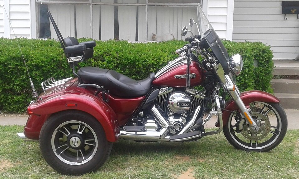

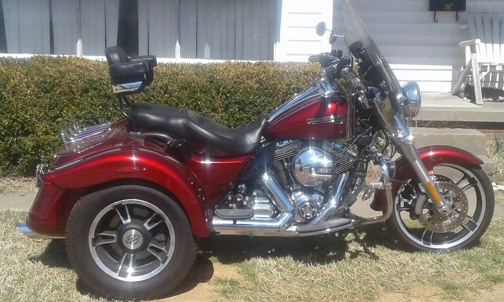

Well - I took mine to a local welding shop and had it heated and bent today - It now is tilted back about 1-1/2 " more than stock allowing Mama to lean back an be comfortable -

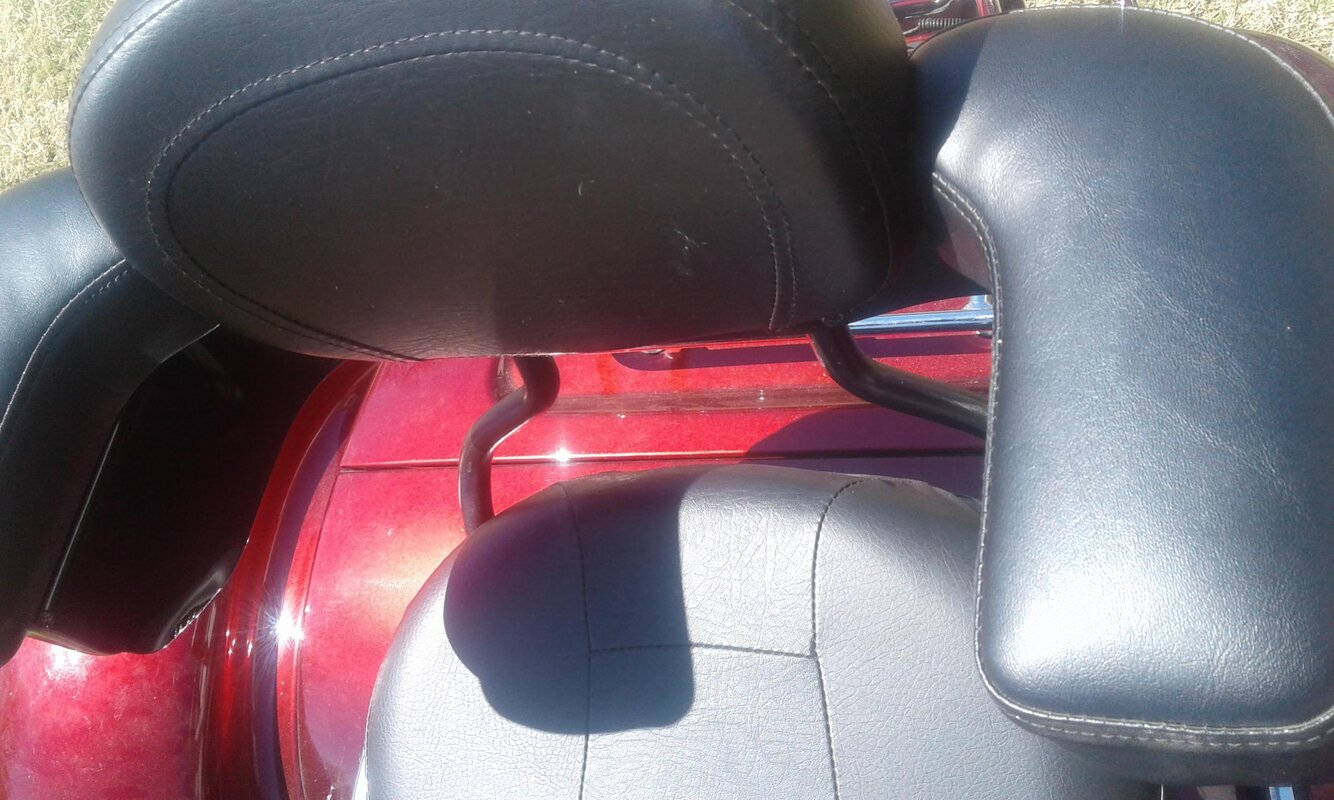

On my 2017 FreeWheeler After I tried to bend my bar back and ruining it. I bought another one. I and using a 2017 ultra classic Sundowner seat, which make it tight fit to back rest with the Corbin wrap around backrest. I ended using spacers under the screws on the backrest base. Put 5 small shim type washers out and used longer screws to make backrest bar sit straight up. Then passenger can have room to move around some

I tried shims made out of washers and stack them about 3/8 inch tall - Still didn't give me the angle I wanted - The local fabrication shop clamped it to a table - Heated it at the first bend and pulled it back about 1-1/2 inches - Couldn't be happier with the result - Harley really missed the ball by not making this adjustable in the first place.

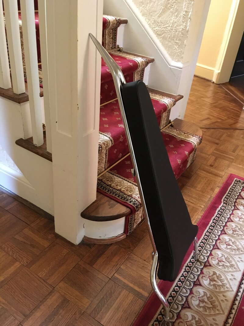

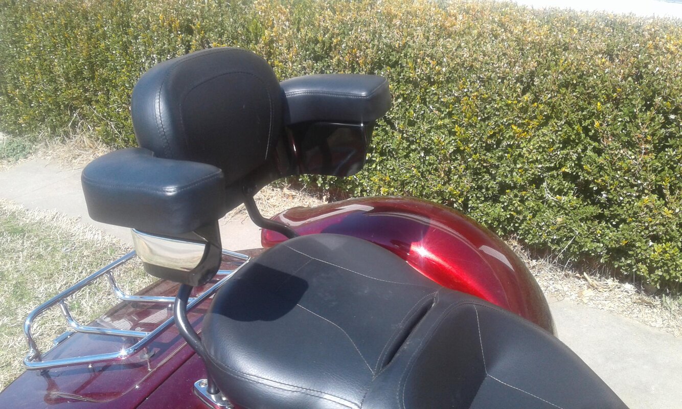

Thought I would post a follow up on this issue - First I bent the bar at the lowest bend nearest the seat - Roughly about about 1-1/2 inches rear ward - later I changed to a thinner back rest pad and added a wrap around arm rest kit - Then I pulled it off and had it bent again this time at the highest bend just below the pad - so it is parallel to the bottom inserts - It was a lot of work but , for $40 bucks it is now perfect and gives the passenger about 2" of extra room to scoot back without leaning back too far to be comfortable .
Cool! Can you post some pictures?
Photos of Sissy bar upgrade as os 3/19
Current Back rest and Sissy bar _ The center pad is no longer bolted to the sissy bar - It is now attached directly to the arm rest plate - Arm rest kit is made by Grabber Enterprises an available on Ebay in various styles - This is the 15" wide version

It really wasn't that bad - I had a hard time finding someone to heat it and bend it - The local muffler shop tried to tell me it would make it brittle and it could fail ( BS for don't want to do it ) - I found a local welding and metal fab shop that did the bends in less than 30 minutes by heating it with a torch ( Fellow Biker and Harley owner ) - As for mounting the arm rest kit to the bar - Measure twice / drill once - Very easy an not that pricey
It really wasn't that bad - Very easy an not that pricey

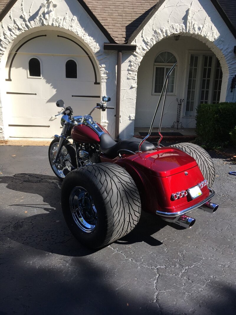

Great creativity! I wish I had thought of it! My wife is small, but I am not, and she says it is sometimes a tight squeeze in the back seat. But my sissy bar mods are already committed to metal and seat pan, so I don't think I will change it any time soon.... I just better go on a diet:Dorag:

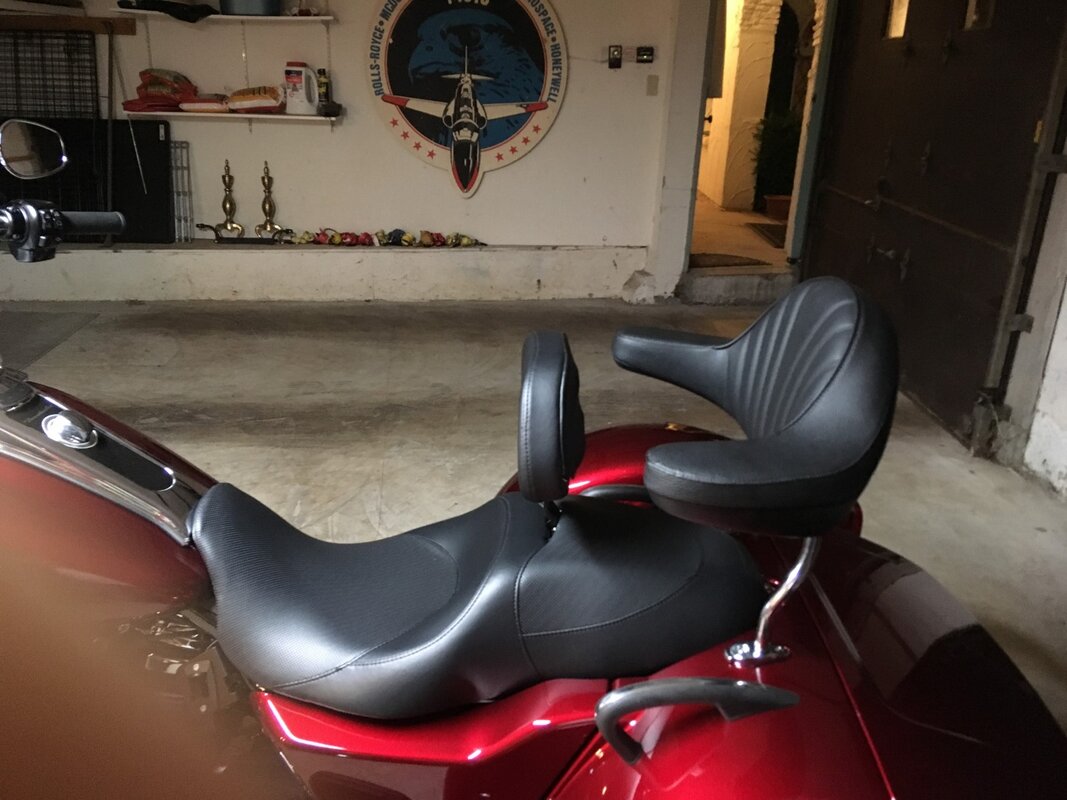

Right... I was really just talking about being able to add two more inches of "rear" space to the overall seating arrangements. I do have a Corbin setup as well for passenger touring comfort Just pull the sissy bar, and plug in the rider backrest... Happy wife... Happy life :D
