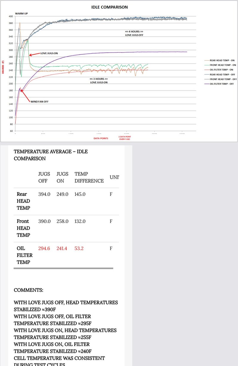

Tony, the only thing that will keep your air cooled Harley trike from overheating while in traffic is cylinder cooling fans. The most effective fans you can buy are the Love Jugs dual cooling fans. They are very high quality, water proof and are backed with a 100% money back guarantee. There are lots of testimonials on the forum about them. Trike Talk is a stocking dealer for these. Read more about them HERE.
Amsoil also just completed and published an independent test on the Love Jugs fans in slow speed at idle and the results were that the Love Jugs reduced the rear cylinder heat by 145 degrees and the front cylinder heat by 132 degrees. See their report below:
