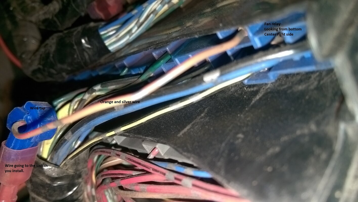

I had mine apart today and the "right" wire comes from the fan relay which is in the relay bank under the seat and marked on top as the first one on the right side center of the relay bank. You need to pull the relay bank off using the two screws either side of the relay bank. Look behind the bank of relays and identify the fan relay.
There will be an orange and silver wire coming from the relay. Test it by turning the key on and using a test light, YOU MUST USE A TEST LIGHT OTHERWISE YOU MIGHT SHORT THE WRONG THING AND HAVE A PROBLEM. Once you have used a test light and the fans came on when you have taken that wire to ground. Now use a wire tap on that wire running the wire you are using to start the fans with and put a switch inline to a separate ground.
This will work as I use it regularly with no problems. If you need a diagram I can make one and I have a couple of pics that I can post as well.

Here is the best I could come up with on short notice. Just click on it and it will be big enough to read.
