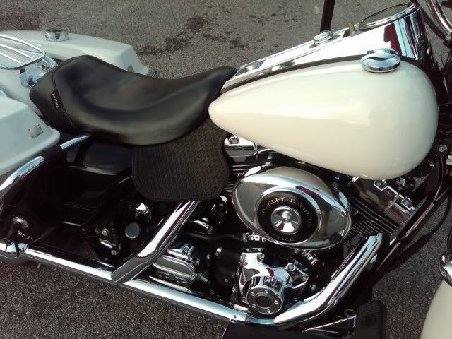

Go with a tuner,pipes,and a K&N air cleaner for performance and to help cool your motor..If you are looking to keep the engine heat off your thighs get a crotch cooler they work very well and are very easy to install..

Captain Itch....I want to order a crotch cooler, but my husband had a question. The shields that are on the TG now are heat deflectors that are supposed to disperse some of the heat across the engine. He is worried that the crotch coolers will hold more head on the heads. You can PM me if you want. I think the question makes sense to me.

Thank you for your email I hope that I can answer your question..The way that they are designed they have a bigger foot print so they work much better than your stock shields.They will not hold any additional heat and your fuel injected bikes have a limp mode that will shut down the rear cylinder till the bike cools as a safety measure..With the addition of our shield no one has ever reported this happening so it does not hold the heat to the point of doing any harm..But it will keep you more comfortable..If we can help you just holler..
