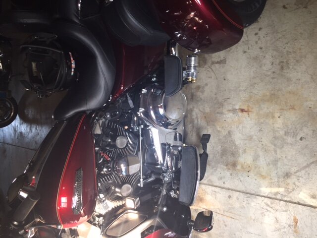

Dual Cool and Oil Filter kit Just added. Used standard hoses supplied with kit. Already think I want to change to the braided stainless hoses when I do I will use an-6 usable fittings and an-6 pipe thread fittings in the adaptors. Assuming anyone attempting this installation is technically proficient with mechanical tasks but one thing I haven't seen mentioned in any threads or mentioned in the instructions. After installing I removed the plug wires and cranked several times to prime the system before starting. I also pre filled the filter and housing with oil before mounting. All in all I can definitely recommend this system fro DK Products
