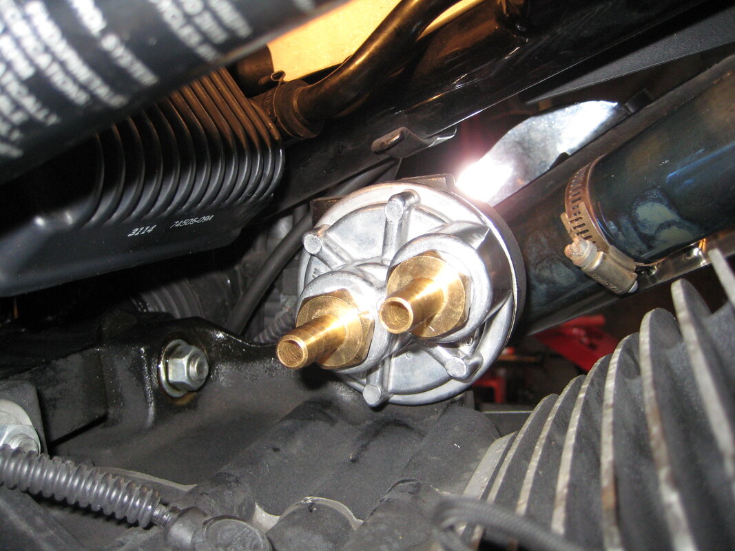

This is where the oil filter use to be. It is now replaced with an permanent screw on adapter (Before Hoses). Very clean and easy to install.

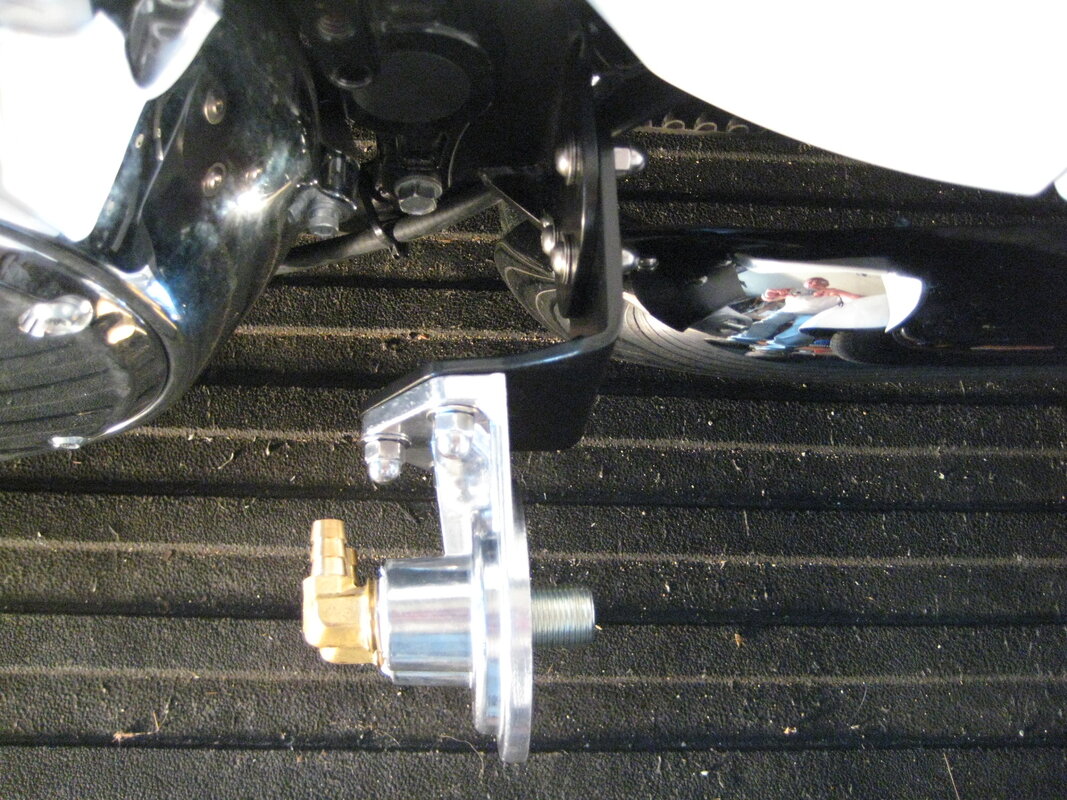

This is the relocated Oil Filter mount. As advertised the two 1/2 inch foot peg bolts that you have to remove to mount the adaptor plate are a BITCH!! Had to use a torque bar to get them out. But after that the rest was easy.

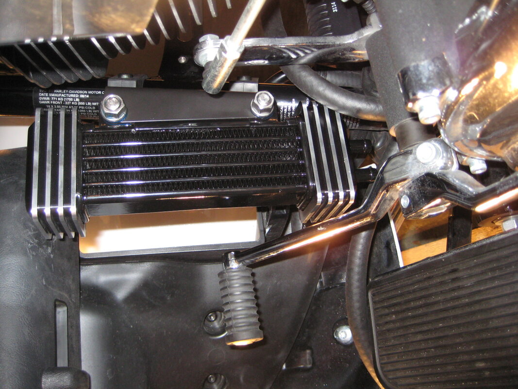

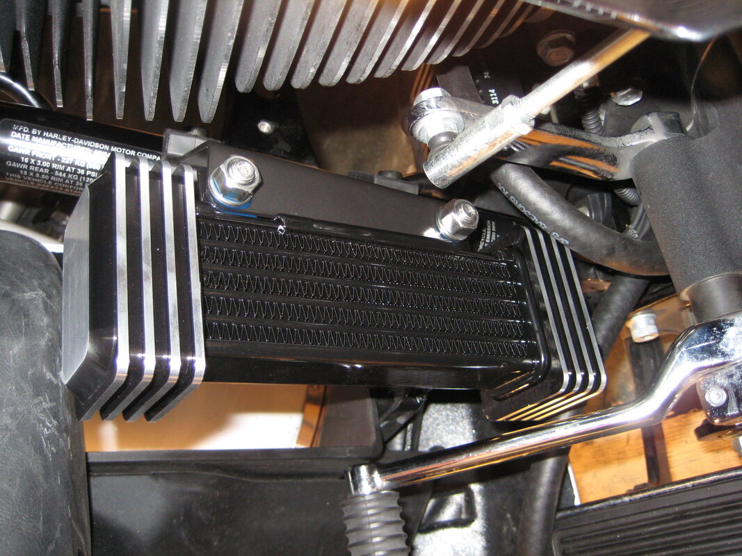

Don't know why this pic is posting sideways ??? Anyway this is the Oil Cooler neatly tucked away behind the fairing vent....... Neat and Nifty ;)
The mounting hardware for attach the oil cooler to the bracket was missing, but a quick trip to the hardware store fixed that.

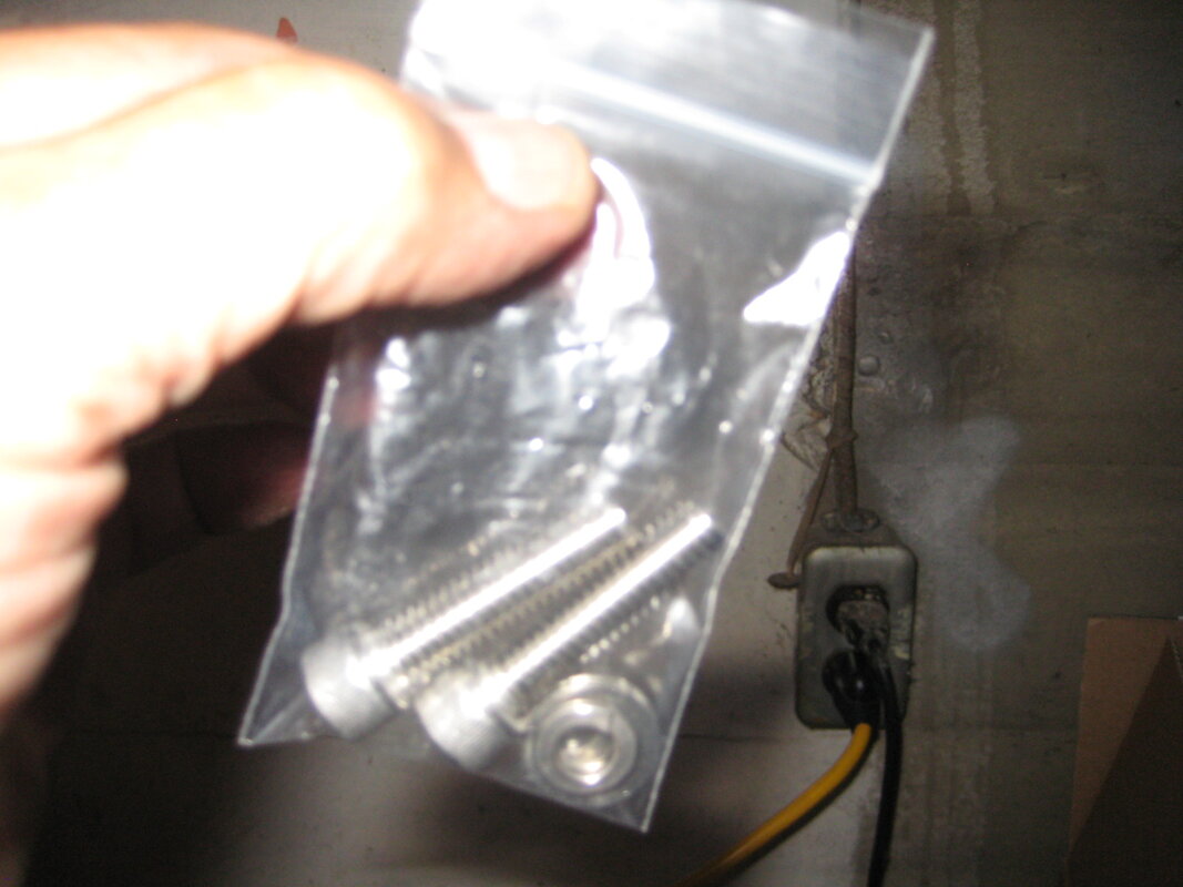

Had these left over.....no freaking clue what they are for. Guess I got a parts bonus :laugh::laugh:

I had 2 left over Allen bolts as well ??? Pictures are loading fine on Macbook today after a system restart. Nice Pictures , I responded to a request in another thread and posted a small poor quality one of mine. Yours will be a good reference for anyone doing this in the future. Kevin has been great through the whole upgrade project. Highly recommend DK for anyone looking to upgrade.
Remind me of the last tv wall hanger mount I did. Got lots of extra metric hardware to add to the metric collection. Best part was a lot of the screws fit a scooter project I built. :pepper:
Neat and Nifty ;)

The extra bolts are a bit longer and are for attaching the oil cooler to the rubber mounts more easily.

looking at the side ways picture, I understand the oil is running cooler but is the heat from the cooler right on the foot or leg area when your foot is on the floor board. BTW nice install and thanks for posting.
When designing this oil cooler system, your concern was a big consideration for us.
It is a bit hard to tell from the pics....
The oil cooler is inboard of the primary. The riders foot and leg are many inches closer to the primary cover than the oil cooler. There is no increase in heat felt with the oil cooler where it located.
The primary is much hotter and bigger than the oil cooler.
Without the oil cooler, as the air flows thru the lower vent, it cross directly over/around the primary and cylinder fins, so the air felt from the vents is already heated by a source much hotter than the oil cooler.
With the oil cooler installed, part of the air from the lower vent goes thru the cooler (inboard of the primary and riders leg) and part of the air (to the outside of the bike) does Not go thru the oil cooler. It still passes over/around the primary as normal before being felt by the rider.
Net result is there is no increase in temps felt by the rider. Instead, since the overall temp being radiated by the engine is less, the overall heat felt by the rider is less.
