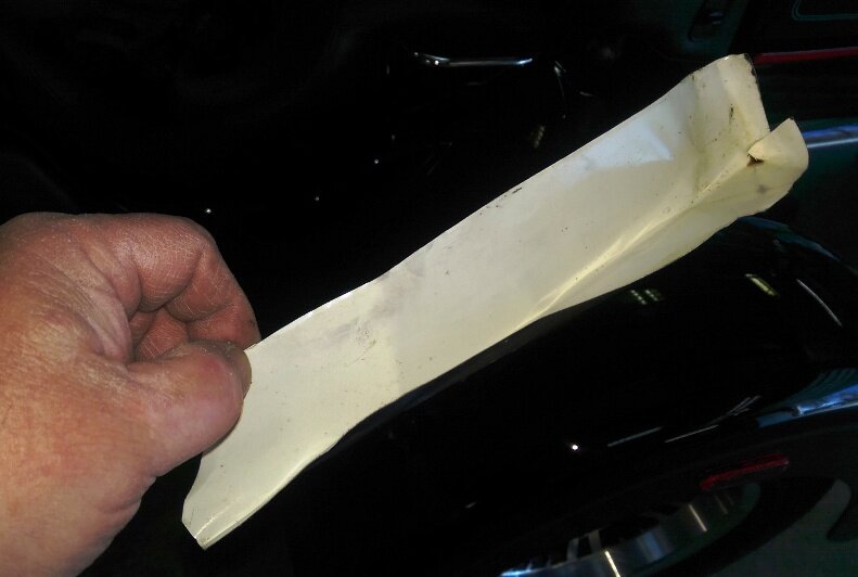

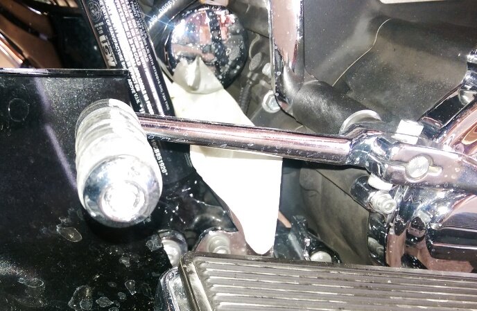

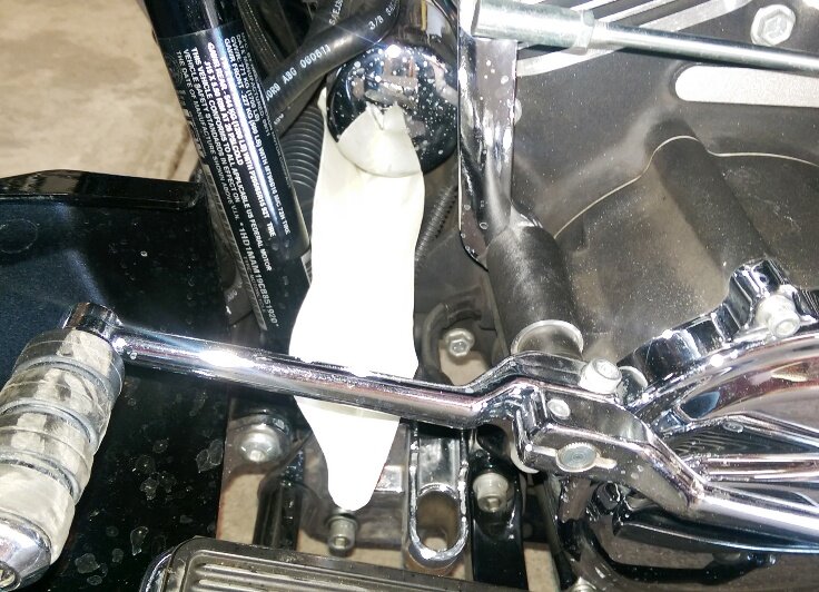

Simple Oil Filter Change Gutter
Finally remembered to take a picture of the tin piece that I bent in half for changing my oil filter. I cant believe everyone doesn't do this. I don't get any oil on the motor, frame or anywhere but in the drain pan. I sure wouldn't do the mashed in rag thing and have to clean it all up. Here are pictures of the little tin gutter.
Milemaker
I used an old alum license plate when I did it, but the plastic oil can cut is a great idea!!!! Although I will say I bite the bullet and put DK Customs Oil Filter relocation kit on and am very happy indeed.
