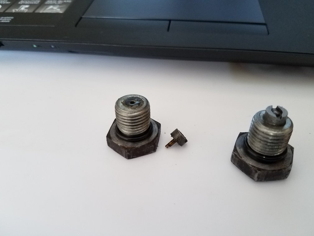

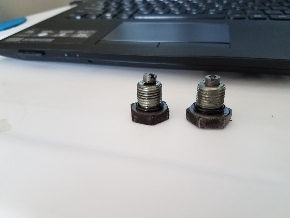

Was doing a fluid change on my trike when I noticed the oil plug looked crooked. After inspection the magnet came right off, kind of scary since it would go no place good. After some research for replacement plugs settled on these Dimple magnets replaced all three. They really do pick up a large wrench where the H-D ones wouldn't even hold them self up. Anyway I figure the price is worth piece of mind. Thought I would share.

Point of post was not price or if H-D cost more or less but the quality of the part. The 3 hole drain bolts from H-D all have magnets on them to help clean metals out of the oil. Since one they are so weak they can not even hold them self to a piece of metal with out falling, not very strong. Second if the magnet is only held in by a pin and can come lose and travel thru the motor, Ouch. Yes I paid 80 bucks for 3 drain bolts a 1000 times stronger and with a guarantee not to ever come apart. I like to save on shinny stuff just like everyone, but when it comes to my motor I spare no expense. After all the motor is 24 years old and still going strong.
