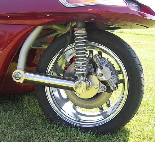

C) Go to Hannigan and have the 180 front end kit installed. This will allow a larger 180 mm width tire instead of the 130 mm currently used. $3-4K installed.
(See Wheels's review on his Hannigan front end)

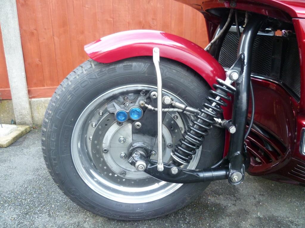

C) Purchase the Eurowing front end that uses a car tire on the front. I have no personal knowledge of this setup but one would certainly think it would ride well.
