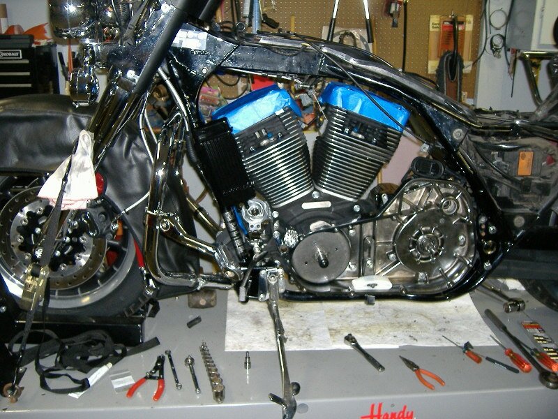

Maybe you'll have better luck, I'm running the 10 row wideline on my 06. Only way I could have kept the lower would have been to tuck the cooler tight to the engine which looked goofy. If you would go under the body you might want to keep something to bypass the cooler with, underneath is a good place for a rock strike. I had a cooler on an 05 Classic mounted in front of the regulator, took a rock hit and leaked oil like a pig. For a cooler under the trike you might want to look at the Oil Bud cooler https://harleyoilcoolers.com/, they say their virtually indestructible.
I hope to get a good angle off the downtube...it seems like I will be able to, but if not, I will go under the body with a scoop, so the cooler will (hopefully) not be terribly vulnerable to rocks. But like you say, keep a hose and some hose clamps with me in case I need to bypass it.

Interesting, it makes sense, hope you can get a favorable angle on the downtube.
Thank you, me too. The pic of the angle on your 06 is not one I'll be happy with. Hopefully the Lowers are a bit further forward on the 14 TG and it will work. I'll know in about a month.
I tried to keep the lowers on the 06, couldn't get the cooler in a position to allow them to fit, doors open or doors closed. The lowers are now residing in my back garage.
