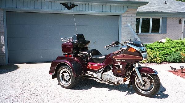

Back in 2000 (17 years ago) I had the same problem. The trailer work well behind the family car but not the trike. A friend recommended I add separate turn signals and go with a five pin connection. I did as he suggested and it worked. Haven't had a problem since.
First Trike 1986 Suzuki Cavalcade with a Tri-King conversion
Now ride a 2003 Valkyrie with a cSc conversion
