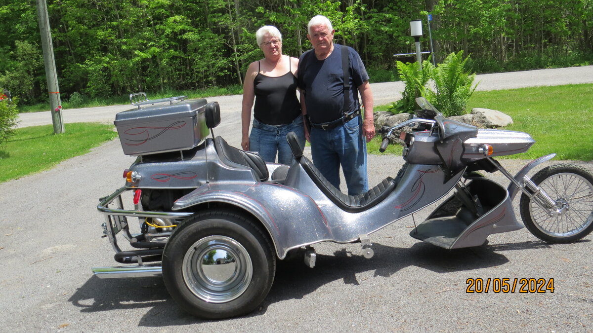

In looking at the avatar pic, is that an outrigger kit or actual trike?
It is an actual trike kit. 3 on the back, 1 on front. 2004 Suzuki 1500 intruder. Just recently purchased so not sure whose kit. Looks pretty, rides rough. Still getting used to. Just sold my 85 vw trike (V Cycle) and was going to stop riding, but can't help myself. Prior to the VW had a 2013 Spyder RT. Found everything had to be done by dealer (400 for oil change) and 980cc for 2 up doesn't cut it. Very sexy looking, but so was my first wife. Last 2 wheeler was Kawasaki 1500, too heavy for my 81 year old legs.

Those are called outrigger kits with 3 wheels in the rear, a real trike has 2 in the back. All that has to be done is unbolt the kit and they have access to the rear brakes so they can be certified. Once the check is done the unit can be reinstalled.
