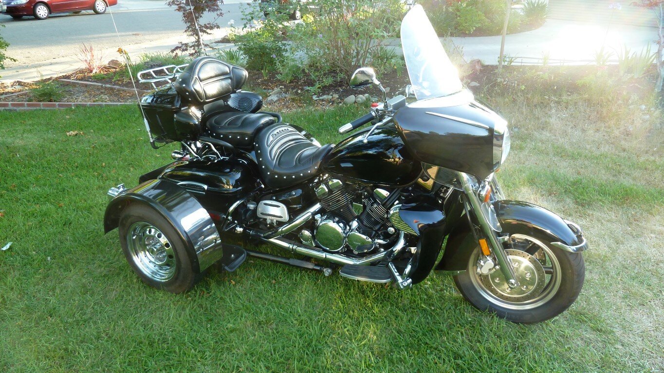

I've posted some pictures of my bike. Took my wife for a ride for the first time on some no so great roads and when we hit a big bump it rattled her pretty good. Don't know if there are anymore adjustments I can make to make the bumps smoother. Does anyone have any suggestions? I have the air in the nomad shocks at maximum and am thinking of letting the air out completely.
