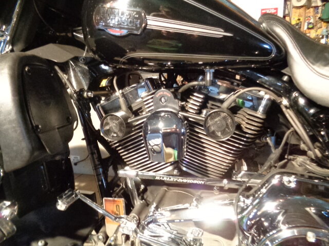

Congratulations on the New ride mine is old so I can't help much but I will say the Mighty Mites are the way to go. I have run them for sometime now and they really make a huge difference. These are small but very effective especially if you opt to get a vertical oil cooler from one of the sponsors "Kevin" LOL. He has a really nice solution to no oil cooler on a heat monster. :Shrug:ride safe Fred

Looks like you mounted the Mighty Mites right behind the horn. Did you use the vibration dampening gizmo? Thanks!

Are they wired to start when the engine is turned on, or do you have to flip a switch? Thanks!
I have mine working off the toggle switch they come with
With the can bus system on the newer trikes if I am not mistaken in order for them to work with the ignition a dealer function with the digital tech scanner is needed
Mine are wired to the battery via the supplied fuse
They operate with the switch that is on them neat and functional it is located on the rear portion of the center support. You can see the switch from the picture I posted. I can't tell you enough about how satisfied I am with the performance of them. Fred
there is a heavy duty one that comes with it follow the instructions to the "T" and it will go without a hitch, however a frame mount is offered but it requires removal of the fuel tank but it is much more stable and less viberation to the fans. ride safe Fred
