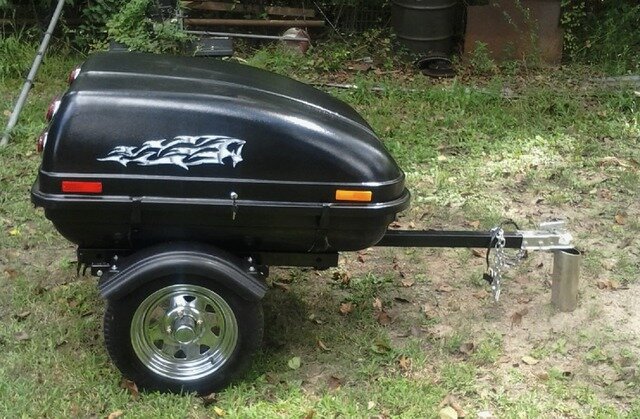

These are good little trailers. Just to clarify, you can add 12" wheels. I just added some washers as spacers between the plastic fender and the angle-iron mount, enough to raise the fender & give about 2" clearance between tire & fender.
Got the chrome wheels/tires off ebay at a good price. The trailer rides a little higher, but just as well as with 8" wheels. Even with only one leaf spring, I put two bags of sac-krete, 160# in the trailer and didn't budge that spring.

Nice looking modification Dennis!! :xszpv::xszpv:

Awesome to know that 12" can be installed with a little work. :clapping:
