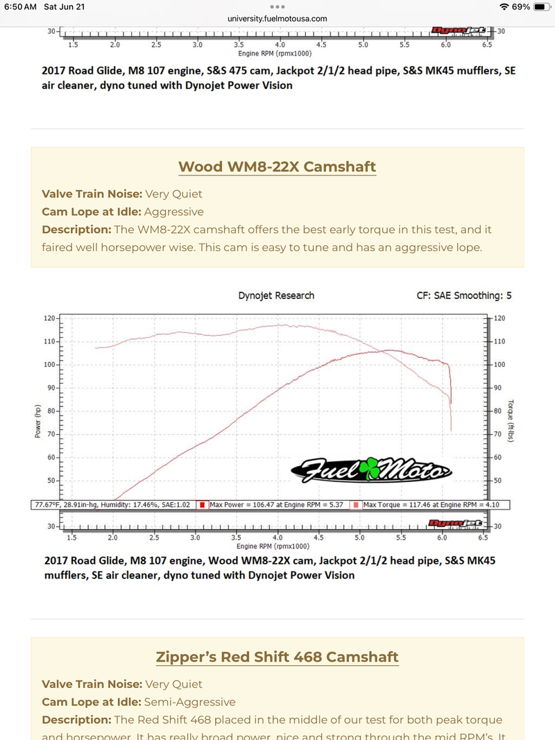

I had an S&S 465 cam put in my 17 along with a Fullsac Sportpipe head pipe, SE air cleaner, SE street cannon mufflers and a TTS tuner with a full dyno tune. Rear wheel numbers where 90 HP and 106 torque. At 2200 rpm it made 102 ft lbs of torque. The dyno guy said that a trike will produce about 10 hp and 10 torque less than a 2 wheeler because of the parasitic drag of the rear wheels.
You are going to get lots of opinions on cams. A lot of it is going to depend on who is going to install it.
If it’s your local HD dealer, then they will push their Screaming Eagle stuff. Nothing wrong with it, but personally I think they are overpriced for what you get and there are better choices out there.
If you or a local independent shop is going to install it, give Fuelmoto a call and ask for Bob. Have an open mind and listen to what he has to say. He’ll ask you a few questions about your trike and your expectations on how you want it to run. Basically, you can have a noisemaker or a stump puller.
I chose the stump puller route and installed it myself. Went with a Wood WME-22XE cam with roller lifters, adj pushrods, improved inner bearing, and S&S lifter cuffs.
While I was at it, installed a Jackpot stainless 2-1-2 catless header pipe, Jackpot M8 Outlaw Street mufflers, AC/DC air cleaner with stock cover adapter, and Powervision PV-2B tuner with Fuelmoto map. A Baker compensator, Screaming Eagle aluminum intake, and NGK iridium spark plugs rounds it out.
Mine is a 2020 after they fixed the oil pump, so I left it alone. If you are changing the oil pump & plate, he’ll guide you on that.
I’m really satisfied how mine runs throughout the entire RPM range. At idle it has a nice lopey rumble, it has a nice bark when hard on the throttle but not too loud, and best of all it has a fairly quiet tone without droning for peaceful long distance rides. My wife & I can easily hear each other on the intercoms, listen to music, and take hands free calls.
Best of all, it got rid of the heat problem with the catless header pipe and proper tune.
Couple of other things that greatly helped was the 1” floorboard extenders, heim jointed shifter rod, and rear shift lever extension that I ordered off of Amazon.
If you have a hydraulic clutch, I installed a Rekluse hydraulic slave cylinder that eliminates the grabby clutch when taking off from a stop and reduces the clutch pull effort for older achey hands.
I also installed the Khromwerks 2+2 Narrow Sweeper handlebars which let me sit back in the seat nicely and reduces wrist fatigue with a flatter grip angle. A Freedom Shields FLH Touring 9” Light Grey Tint windshield helped tremendously with helmet wind buffeting for both driver and passenger.
