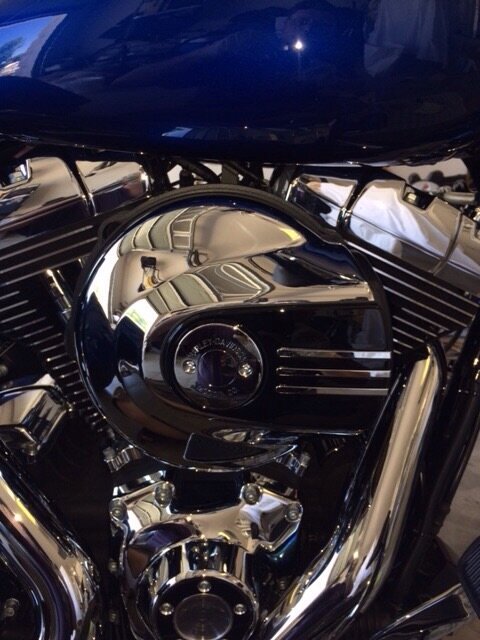

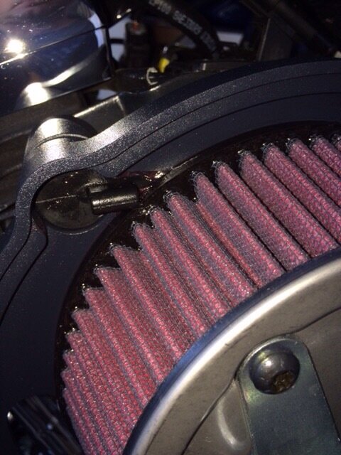

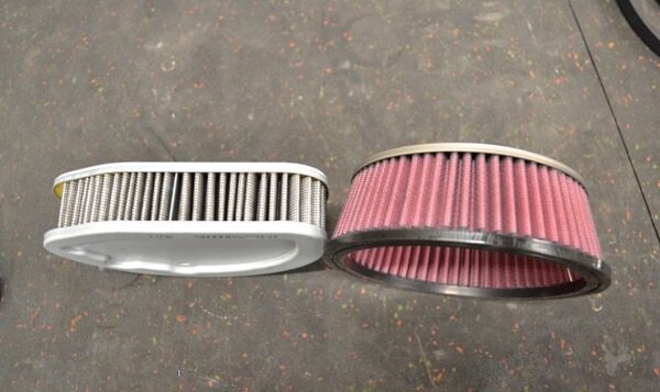

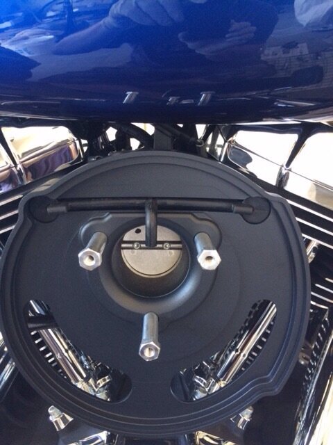

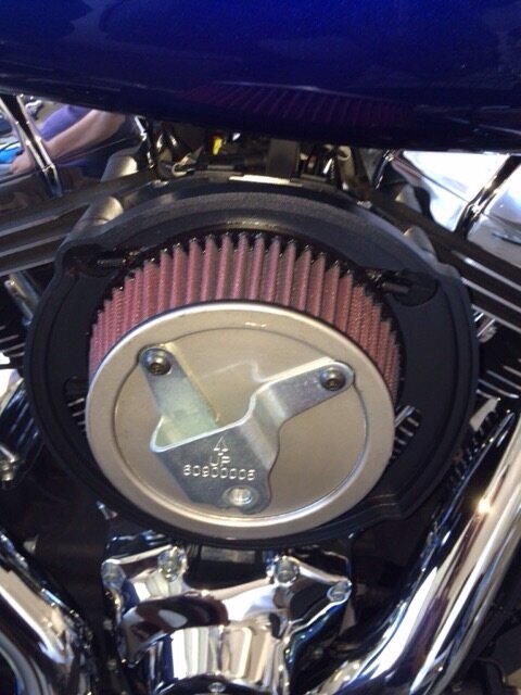

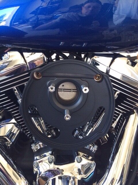

The Fuel Moto Pro Billet stage 1 kit rocks. It fit clean and looks clean, very well made. The stock cover fits perfect and at a glance all looks stock.
I did did use a little filter sealing grease with the K&N type filter around the filter sealing area and where the breather cross over tubes go under the filter at the top. I did this to be extra safe and have always done this on all K&N type filters applications ( old dirt bike habits are hard to brake).
I set my Nightrider FL-Vied-10 units from the 50%/14.2% fuel ratio set point to the 75%/14.0 fuel ratio set point after the stage 1 kit upgrade and My Freewheeler runs great and has a nice crisp throttle response.
(NOTE) The Freewheeler still ran good at the previous 50% set point with the stage 1 upgrade kit but it just ran a hair better at the 75% set point with the stage 1 upgrade kit installed.

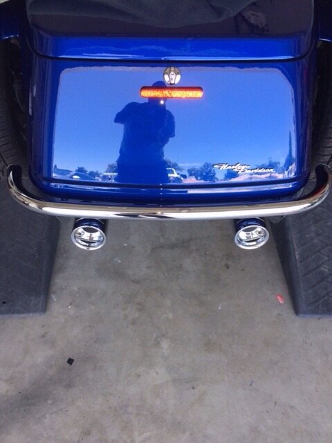

*D&D Exaust 3 1/2" Touring Mufflers ( Short Rounded Billet End Caps, keeps mufflers short behind chrome bumper) with the 2" Vortex Baffles.

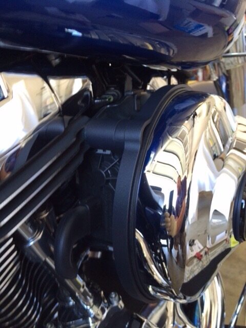

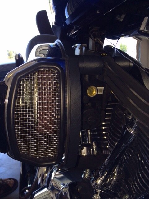

I am very anal about keeping my trike clean so I try not to ride in the rain :AGGHH:( Pain in the Butt to detail after riding in the rain).
I don't really know to be honest as I have not ridden my Freewheeler in the rain yet. Harley designed the cover that way and all the 2014/2015 Mt Rushmore Touring model Harley's all have this type air cleaner covers from the factory.
What I liked about this particular stage 1 kit is it was designed to be used with the factory 2014/2015 Mt Rushmore snorkel covers. The cover works like a cold air intake by design. I do think the screen would defuse some of the water issues.
(Note) You could also see the stock air filter the same way through the snorkel. That did not change at all. With the new stage 1 kit it just has a bigger air filter and a much better backing plate to guide the air into the throttle body. ( Built in venturi to throttle body and air holes in backing plate design).
