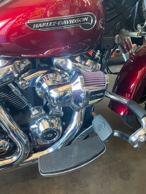

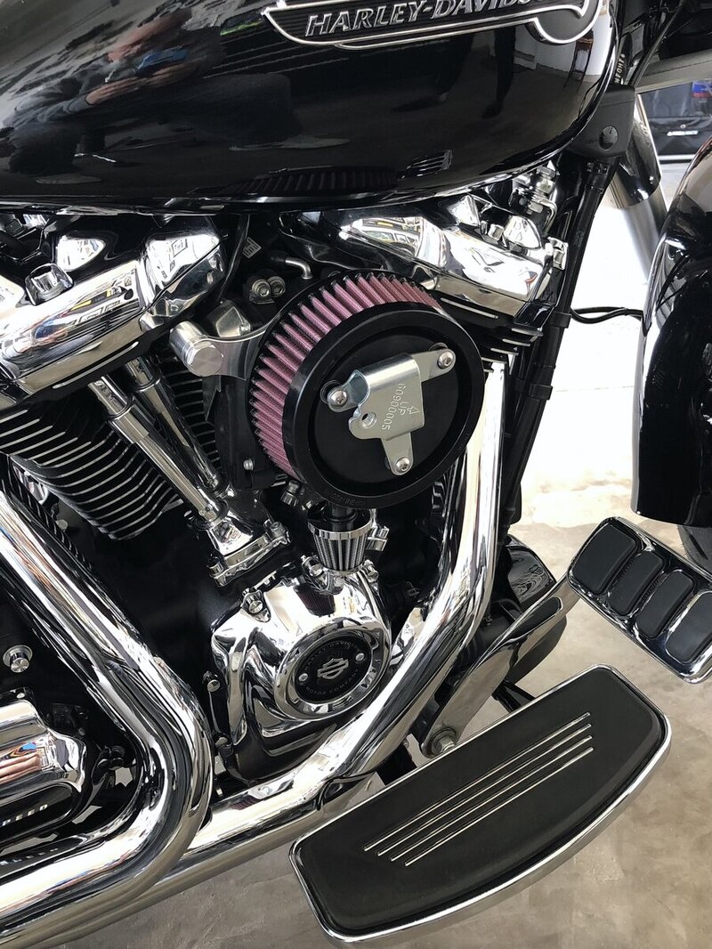

The 1st. thing I did was install an external breather system & installed a K&N air filter element in the stock box. The performance boost was noticable. If I had it to do over, I would have gotten an air cleaner from DK Custom Products. I like the stock exhaust, so I left it alone. The other performance upgrade I did was replacing the stock plug wires with Thundervolt 50 wires from DK Customs. They are amazing & really wake up the M8. For heat management, I installed a 1.5" deluxe tank lift & air wing deflectors, both from DK Customs. They together helped cool the M8 & helped with wind buffeting on my FW with a 20" HD windshield. While my tank was off for the plug wire install, I replaced the OEM plugs, but they looked good (2 years use).

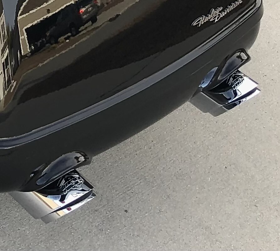

I have a 2017 Freewheeler with the M8 107. I added a K&N high flow breather and Cobra 909 slip-ons specifically for the Freewheeler. That simple change netted me 5 hp and 12 lb/ft of torque. So it seems the M8 responds nicely to even minimal modifications.
I did not flash the computer, I didn't see the need. The little bit of extra oomph was what I was looking for. This year might consider a drop-in cam, but will ride it like this for a few months before thinking about that.
I've got a '21 Free with the M8 114 and did the same thing, including the Cobra 909's. Didn't do any dyno's or ecm flash and noticed a definite performance boast. No backfiring or popping out of the exhaust, plugs look to be burning just fine, no unusual heat. DK Custom has a vid about it.
As has been stated a few times . Slip ons , an external breather and a good high flow air cleaner will give you a bit more pep and 99% of the time you get by without a tune . It will run better with a tune but it’s not necessary. My 21 TriGlide ( same drivetrain) rode two years just fine without a tune , then I went Stage two with cam n other than xtras and had it tuned with Powervision . Runs great now!!!!!

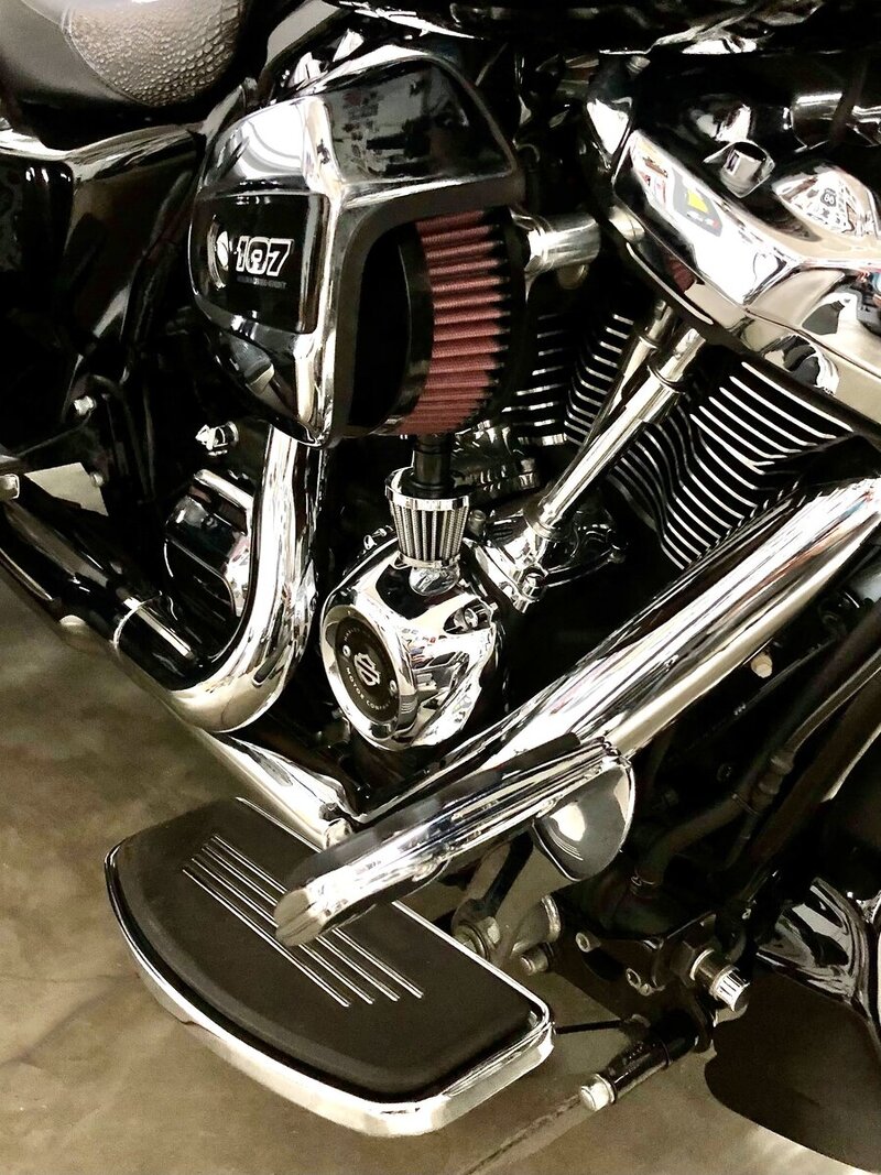

Hey, I know this is an older thread, but let me throw my two cents in here. I did the following to my 2017 Freewheeler/107:
  • I pulled the original airbox and installed a high flow K&N filter unit.
  • I replaced the stock mufflers with Cobra 909s, which are made to match the profile of the bottom of the Freewheeler's box.
  • I installed a Legends 1.5 in lift to change the angle of the shocks and add compliance to the suspension. The difference is magical.
  • Changed stock plugs with NGK CR9EIX plugs.
  • Changed stock plug wires with Twisted 12 mm wires.
Net change (dynoed at my local shop) was 13 Hp and 17 ft/lbs torque (avg. 3 runs).
I had no wherefores and whys to what I added other than my budget and word of mouth. I can say the M8 responded nicely to some tasteful upgrades, and I am quite happy with the outcome. I have no issues staying with the 114 trikes in our group.
