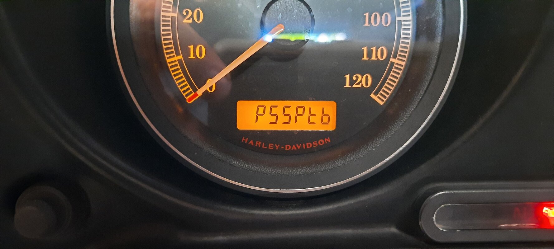

When I go into diagnostics it begins with [FONT=&quot]PSSPt but it has a "6" or a "b" at the end. I have researched but can't find what it stands for. Any ideas?

When I go into diagnostics it begins with PSSPt but it has a "6" or a "b" at the end. I have researched but can't find what it stands for. Any ideas?
That looks more like a part number or a module code I have not yet seen
Try again, you should see something more like Po151- P2603 with no letters or prefixes after the number

You did not follow the scan I gave you far enough. Re scan your bike, pay attention to the following steps
[FONT=&quot]4 - Push the odometer reset button once and you will see the selection menu "PSSPt" with the first P flashing.[/FONT]
[FONT=&quot]5 - Each letter represents an area of the diagnostics module. The module that is flashing is the one you are going to check. To move from one letter (module) to the next, you push the odometer reset button one time. (from P to S to SP to t and back to P, etc.)[/FONT]
[FONT=&quot]P = ECM/ICM(Electronic Control Module)[EFI] /Ignition Control Module[Carbureted])[/FONT]
[FONT=&quot]S = TSM/TSSM (Turn Signal/ Security Module)[/FONT]
[FONT=&quot]SP = speedometer[/FONT]
[FONT=&quot]T = tachometer[/FONT]
[FONT=&quot]6 - To get the DTC within an area of diagnostics, push and hold the odometer reset button in for 5 seconds and release. If there are any DTC's the code will be displayed or the word "none" will appear if there are no DTC's. Push the odometer reset button again to view additional codes if they exist.[/FONT]
[FONT=&quot]7 - Record the codes.[/FONT]
You really need to change the battery on the FOB before doing anything else. If it's weak it may not be triggering the security system all the time. Other choice before going further would be to de-activate the security system if you wrote the code down.
To retrieve the Diagnostic Trouble Codes the engine run/stop switch MUST be in the RUN position. What you displayed in the photo looks like perhaps you ran the test with the switch in the stop position.
