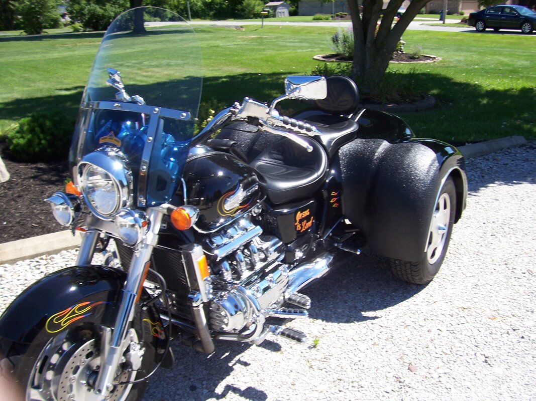

I made my own using some really tough adhesive backed pebble grain vinyl intended for steps, like on trailers, etc. I had planned on going with Line-X at some point, but these that I made are doing the job still. No sanding paint off, etc. Doubt I'll do the Line-X now on trike now. I found stuff on Ebay, easy to cut and apply, used wallpaper roller too. Made patterns, gently used heat gun when rolling over curves too.

At one point, for a few years and good many miles, I used really dark static cling window tint, never had a rock hurt that either, but this textured vinyl is tougher. I also did the lid of our Cycle Mate trailer years earlier, still there.

I mentioned a 5% dark window tint, it's static cling, and if not being fitted around lights, etc, can be easily removed and repositioned if need be. I used it far a few years, never an issue with it coming loose unless you wanted it removed. I applied using a few drops baby shampoo in water in squirt bottle and as soft plastic squeegee.. Wet fender and film, put in place, squeegee from center out, then wipe dry. I used to wax it too. I thought this picture was good in that it shows how color shows through. I was looking at going back to it, but the stick on vinyl is fast stuck on, so I'll leave it be. In this picture you can see I accidently cut it too short, best to cut lower edge with razor after apply. I decided on width and length and where the lights were, I just should have left a quarter inch more at bottom and trimmed that after dry.
