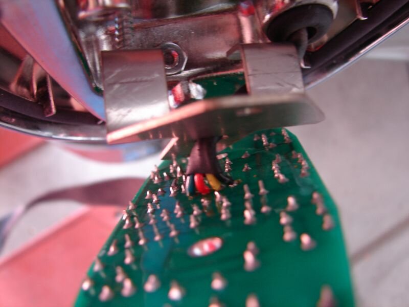

Okay guys I too want to upgrade to the 100 light LED tail lights, however I am a little confused between this talk of plates and boards? I am thinking the plate holds the boards, right? So being the 100 light board is of a different shape than Hannigans original 14 board and plate I would need to change the plate to accommodate the new 100 light board. Right? I have four wires going to a plug under the body see attached photo, so in order to keep the same plug I'll need to splice in the four new wires.... Any clarification or help would be helpful..

Yep you're on the right track "the paparazzi". Just test the wires for function and do the same for the new boards before splice them in. Even thou the new boards are a different shape they still slip right into place. If I recall the new boards utilize the lens cover screws to hold them in place. This is an excellent upgrade and well worth doing I might add.

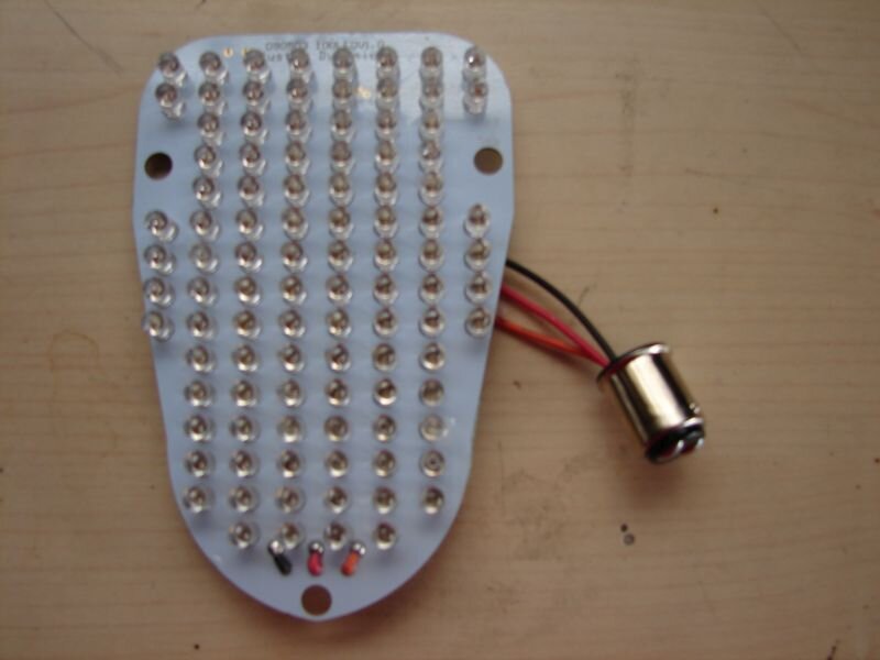

Ordered the LEDs 11/12 received them today 11/14 and they shipped them priority mail and at their cost! Hard to believe, however they are not cheap at $89.95 each..
Anyway as you can see from the attached photos they came with three wires and attached is a 1157 male plug setup to enable it to inserted into a stock bike socket, obviously those plugs are cut out and then spliced into the exiting trike wiring . My existing LEDs have four wires...... So I'm guessing as long as I have running, turn, and stop lights I'm good......However at the same time I'm asking my self why did Hannigan run four wires in their LEDs and do I need to run a fourth wire? and if so where do I attach it? I have set up lots of trailer wiring and some auto for that matter over the years but just not familiar with these LED's

OK , if you don not care about the back off part then you will be fine
with those LED's as it is already built into the Hannigan board itself.
When I did what your doing I removed the old ones from Hanniagan
and put them into my 66 VW Beetle .
Now back to if you want them to flash as before you will have to get
a back off unit controller from http://www.customdynamics.com/street_magic_harley_davidson_led_taillights.htm
then you should be good to go !

Ok it's been a while since I did this but I do remember running into the same problem. Hannigan had a load equalizer I had to remove. I don't think it was required with the larger number of LED's in the new board. I installed a trailer wiring converter with a built in flash sequence when the brakes were applied. So in the end I completely rewired from the bikes stock wires under the fender to the lights themselves. For me it was easier to start from scratch then to keep trying to figure out what Hannigan did. Also cleaning up the wiring and sealing terminals with shrink wrap. Larry
Yes ! Larry, we did this about the same time and had I to do the same thing.
Remember we also had to add a resistor as well to make the running light dimmer
as well... its all coming back to me now LOL
Hannigans Tail Light board has the load equalizer built into there tail light boards.
At lest that how it was 5 or 6 years ago.

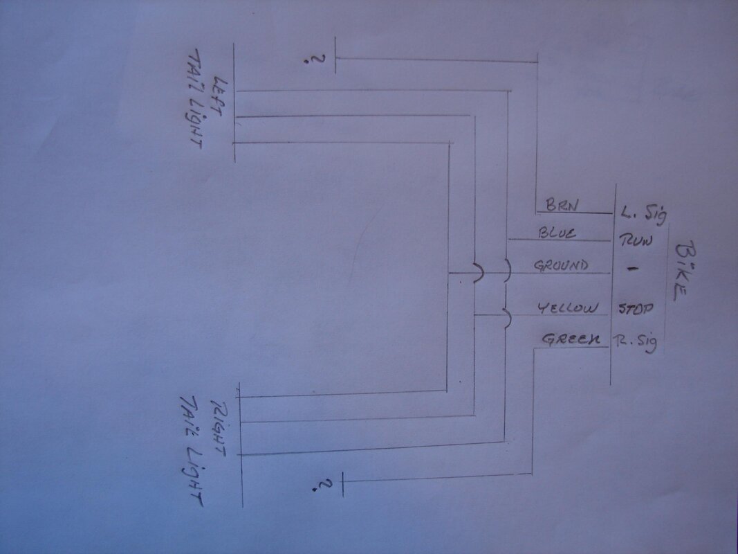

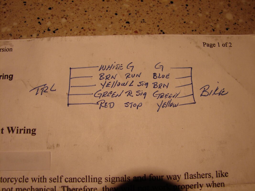

I sure appreciate both of your inputs but I'm still confused, but that's not to unusual for me..I found a wiring diagram that I used to wire my trailer several years back with no problems, I still have the trailer and tow it with my trike.. See attached. Maybe I'm all wet in trying to compare that diagram with the taillight diagram I just made up, but as you can see with the three wire upgradeLED's the directional signals come up short ? I realize the color codes really don't mean much, its what the circuit does that counts..
