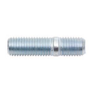

Studs come in just about any thread and length you can imagine. You just have to find the ones that fit your set up.
The short end the length and thread you want.
The long end the length and thread you want.
Screw the short end in the hub with lock tight until it shoulders out.
