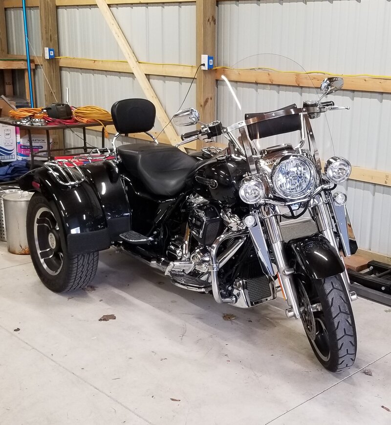

my 2017 free wheeler

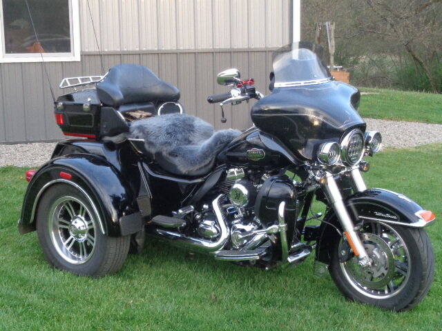

Welcome to the forum Mike from Western Pennsylvania very nicely done Freewheeler. I also believe you have chosen one of the Fastest colors. I am partial to it myself...DSC01685.JPGRide safe Fred
light bar
Very nice - - Where did you get the Fangs (wind deflectors) and are happy with the way they work.
I do not have the light bar you have, so wonder it they will fit my 2016
Thanks,
the light bar came from an older road king, fit on there perfect on bike. picked up at swap meet for 20.00. not sure about 2016 but the 2017 is already pre wired for the driving lamps. you will need the switch p/n 71522-08 which mounts on the left side accessory access switch hole. wiring plug is wrapped by left side of gas tank. you will also need the led fog lamp harness p/n 69201108. this makes it all plug and play you will have just have to decide which lamps you want to put on. being that I put the wind deflectors on too I also replaced the mounting studs for the turn signal lamps, the ones that hd put in there are 1.5 in long with 5/8 in thread on each side I purchased 1.5 in long from carr lane in stainless steel with 1/2 in thread on one side and 3/4 in thread on the other side this gave me about 1/8 in more thread for the acorn nuts to hold all this together
