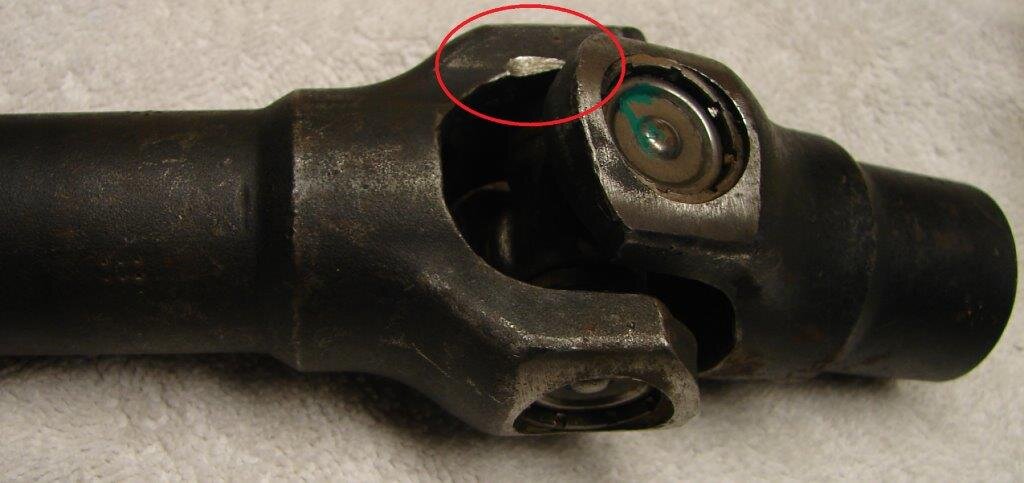

I had a Motor Trike drive shaft that was going out.
How did I tell??
I heard chirping/clicking when ever I used engine breaking.
SOOO Took it to the dealer, and we both got under the bike. Neither of us could find the problem.
Took it down and went up the incline out of his shop, and the thing let loose.
LOUDLY!!! Chirp,Chirp,Chirp,Chirp,Chirp, Click , Click Click
So back in the shop we went and REMOVED the shaft. and the inner yoke had been hitting the outer yoke of the front Ujoint
You can see what happened.
So he went into his ROOM-O-PARTS and got me a front u joint from a 1500 (i understand they are the same parts between a 15 and 18)
OffI went, and boy was it smoother, Ujoint just don't go bad, they gradually make your ride miserable, until they completely go.
But by then I was totally spooked about the drive shaft, so I ordered me one of MT's NEW drive shafts. and after putting it put... BOY was it a better ride.
Visually the front u joint is about 30% to 50% bigger than the one it replaced. and the drive shaft is notched... no more timing issues. Slipped right oon and it has been great so far
