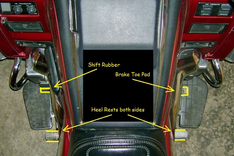

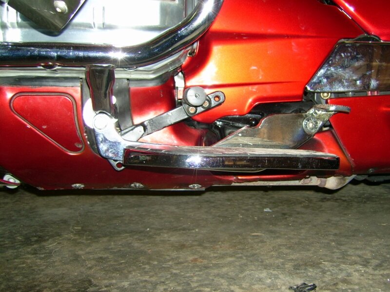

I started with stock pegs on the trike but then an old knee started kicking me at times ..... never bothers me on the 1200 bike? After one particularly bad day I bought Low Boy floor boards and very soon started modifying them in stages, starting with the H&T shifter making it a toe shift again.
Now, I have forward floor boards on the guards, the low boy floor boards, or short abbreviated pegs in stock location that served as heel rest when shifting and/or braking. I got the idea for them when I saw how comfortable the right side was to prop my heel up and leave it at times ..... so I used the toe pad off the brake pedal that matched and welded it over on the left .... then used the toe pad off the stock brake on the new lever that came with the floorboards. Eventually I made my own shift lever and made it adjustable for winter vs summer boot toes.
Last year I added a "Shift Brace" as well.
I'm pleased.
