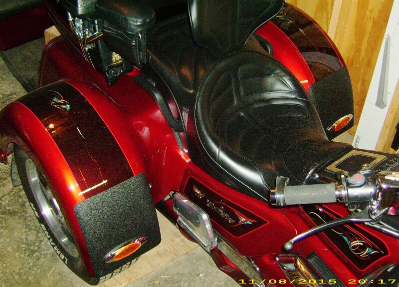

Not a Monarch I or II, but an older GTL. Bought the LEDs at a local truck stop, chrome bezel snapped on/off. Three holes each, two near ends to mount, larger center one for wires. Bent a 3/16" galvanized rod to shape & used it to support wiring away from tire. Later on, I added a red one under the trunk as another brake only light.
