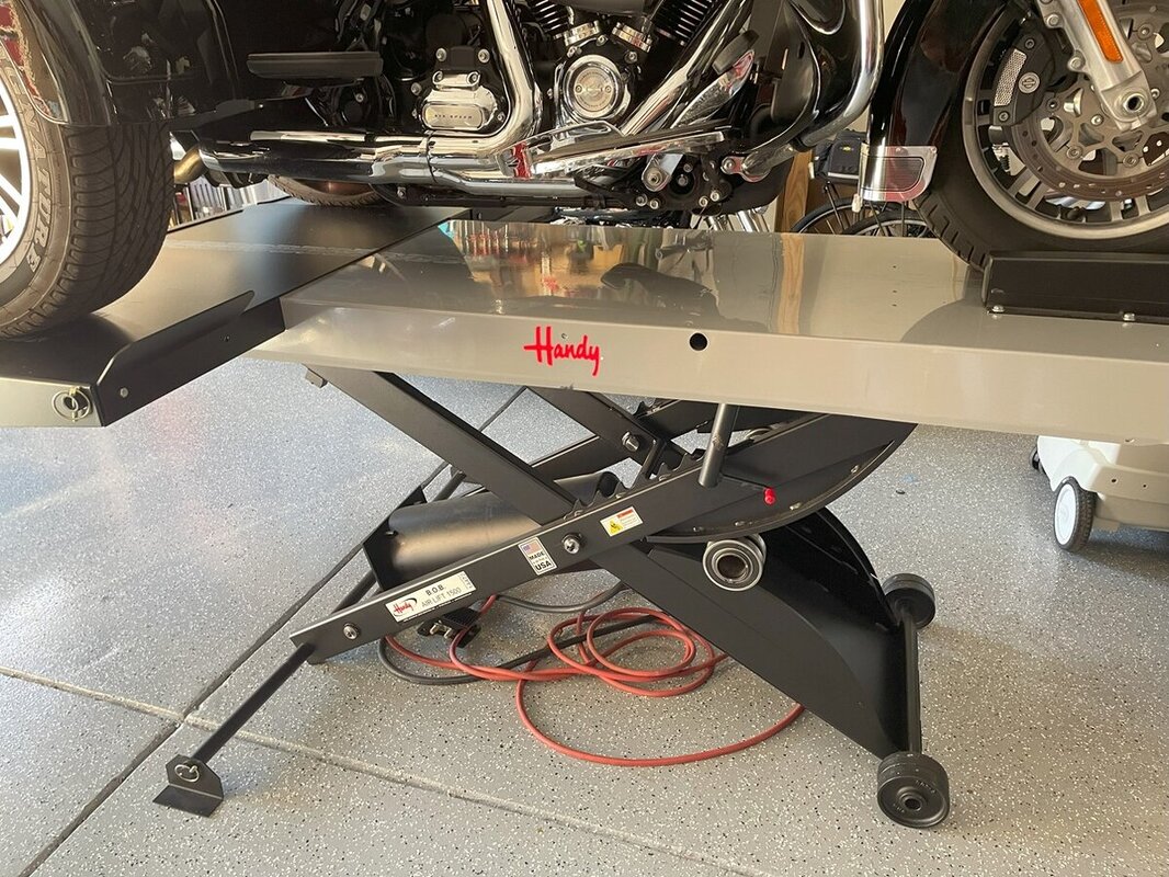

I sold an almost new Handy lift that was rated for 1,200 lbs, because it seemed to struggle to lift the trike, and the wheels were slightly wider than the side extensions.
I bought a Handy BOB 1500 lift, it is rated to lift 1,500 Lbs. and is designed to lift a trike.

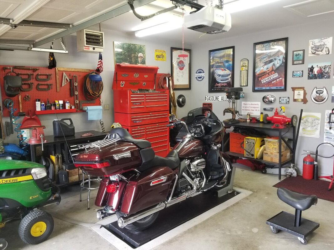

Thanks for the information but this bike is under warranty for the next 5 years so other than normal service I won't be working on it. 3500 for a lift just doesn't make any sense to me, money is always a consideration. I put my lift in the floor several years ago so it wouldn't be in the way when not being used and I'd need to redo all that also. Nope, I'll just leave things as they are but thanks again20200516_123843.jpg
