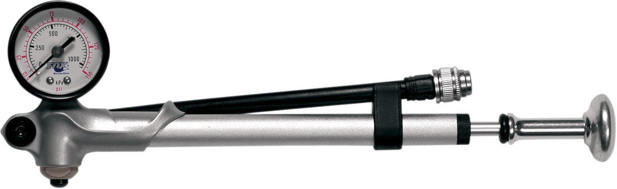

Alright, after much research & reading 1,000's of reviews, I ordered a hand pump for adjusting the air shocks on our Freewheeler & I am sure it will work on other models also.
It is a AlphaMoto Air Shock Pump For Harley Air Shocks 0-60 PSI.
I have played with it for 2 days now & I am declaring it a winner.
It is well made, compact & very accurate. It has a bleeder valve for micro adjusting the air down to the perfect setting & when you unscrew the hose from the fitting, I saw/heard no air loss. It was on E-Bay for $23.85 with fast, free shipping.

1 other item. In my research, I found some pumps that look very similar, but have a 300 psi gauge & you are better off with 1 in the 0-60 range as our max pressure on our air shock system is 50psi.
I keep mine in the 15-20 psi range. I think the higher range is for mountain bikes front suspension.
Does anyone use these to check tire pressure?
I have a digital tire gauge that I like, but I would not want to try to pump up a tire with this, as it's a low volume pump.
I guess you could use it as a tire pressure gauge, but screwing it on/off would get tedious.
I already had a Fox Racing hand pump and you are right about being careful with the use of it. But you lose 2 to 4 pounds of air putting the pump on and off so figured, why not use it. It works just fine. Mine goes to 150 pounds. Work fine on my 07 electra Glide and works fine with my Indian now. Although I got another from Indian anyway. I person might think they could air up a tire and I suppose you could but it really does put out a very small amount of air. There are better tools for tires.

The 0-60 psi gauge is better for this application because you don't want to use any gauge in the bottom or top of it's range. You get your best accuracy in the mid-range of it's scale.

Based on MDO's recommend I grabbed one of these pumps off fleabay for $24 and have to agree....the little pump is well made, works smoothly and would travel easily in the corner of the trunk. I'm glad I got it, thanks for passing this on MDO. :clapping:

Im happy with it. Just for grins, I hooked it up to my tires & used the bleed valve to take out a couple pounds.
The analog gauge is consistent with my digital tire gauge.
Gotta be honest here....10# is just not enough shock air for a 6' 5" 240 pound driver! But after putting in another 20# with my new little pump the difference was like night & day! Went for a quick test ride around the block and didn't come back for an hour & a half!! The 'block' grew & grew!! :D
