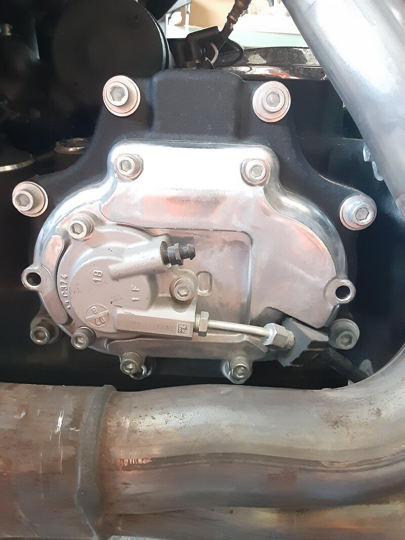

Completing a service on my 2018 M8. Need to remove the right side transmission side cover to access the clutch bleed valve. Problem: the exhaust is in the way... big time. I can remove the two hex screws needed to remove the cover, but there is not enough clearance to get the cover off. I have removed the exhaust shields, loosened the exhaust crossover and the exhaust mount bracket, but the exhaust pipe does not budge. I DID NOT loosen the exhaust flange at the heads.
Has anyone had any experience with this? Am I going to spend the entire day removing the exhaust system so I can bleed my clutch?
Why? you ask, am I even messing with it? Well, it's a two year requirement. I do my own services... and the DOT 4 fluid is a bit discolored, meaning there is some moisture in it. Thanks a heap for any and all answers... even if you just tell me I'm a dumb shit for attempting this.

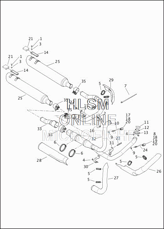

Here is your exhaust, #30 and 15 are exhaust hangars to loosen, on # 30 remove the nut #4 the hangar will hinge down
Thanks, Jack.;) I have the manual and also studied that diagram earlier today. I think I'll start fresh on a new day. I plan to remove the exhaust heat shields and maybe replace the hose clamps that hold the shields in place while I'm at it. That bracket (#14) at the exhaust tip looks very tricky. Will I need to lose that also?

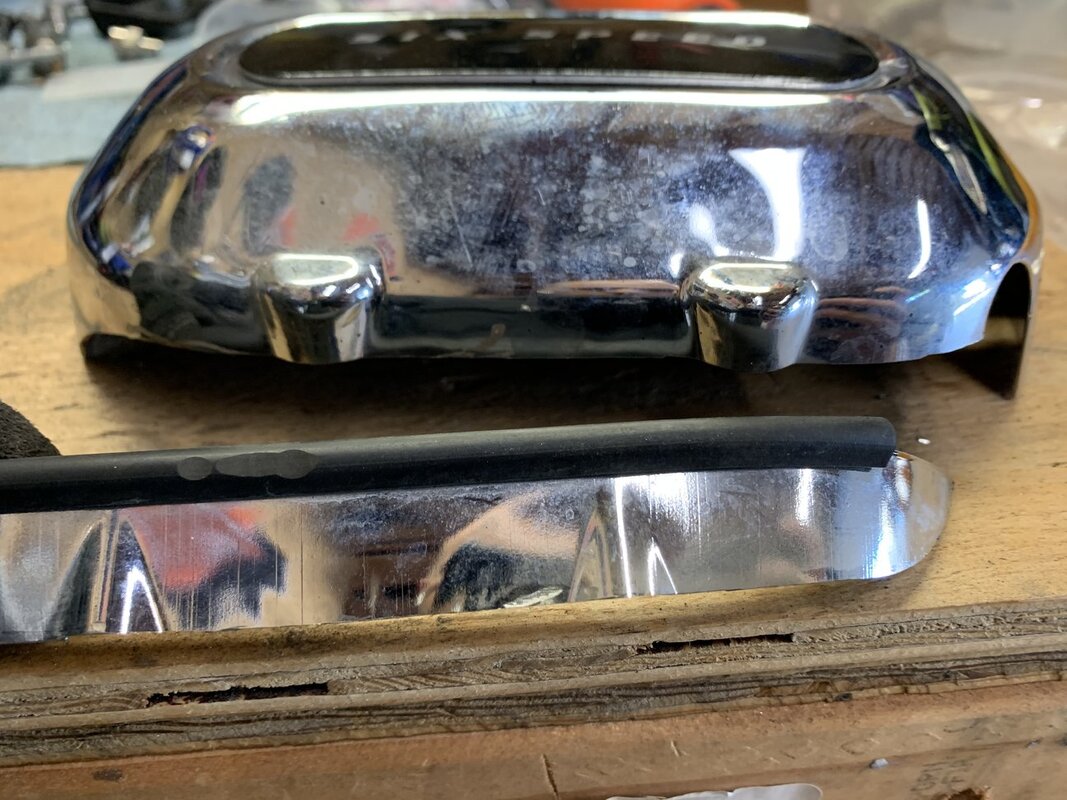

David,
I went through the same thing when I changed my slave cylinder to the Lite Force. Once I got the cover off, I cut a section off of the bottom to avoid this again when it’s time to bleed it. With the pipes back on less heat shields and a little cut then testing a few times, I found a sweet spot where the cover will come off without loosening the pipes. With the heat shield in place you can’t see the cut away either.
Steve
Thanks Guys: Today I took the long road. Removed the heat shields, loosened the exhaust flange nuts just out to the end of the studs. Loosened the muffler clamp and crossover clamp and the one hangar bracket on the header pipes. It still took a bit of persuasion to pull the headers out far enough for the cover to clear, but I did get it off.
I had enough DOT 4 to completely flush the system through two times. Nice and clear now. Good for another two years. The rest of the DOT 4 will get recycled with my next oil change since I can't use an opened container that's been sitting on a shelf.
Thanks again to Jack and everyone else who responded. P.S. is that next time I'll loosen all the exhaust clamps and brackets so I won't have to struggle to pull the dang thing only about 1/2" out for sufficient clearance.
