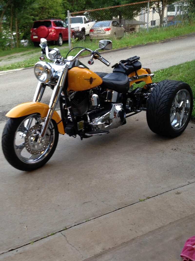

I just finished converting my 2001 Fatboy to a Mystery Designs IRS trike. It turned out perfect except for a low speed wobble that doesn't go away. I changed the stock 16x3.5 front wheel to a 18x3.5 RC Compontant wheel and a low profile Avon tire that seems to fit perfectly. Except, now that I think about it, the new wheel is almost 1/2" narrower than the stock and i used the same spacers, not even sure if I have the most chamfered end facing away from the wheel on both sides, or even if that would make much of a defferance. What do you all think or know what could be the problem? I have a 7 degree steering head that makes it easier to steer and eliminate high speed wobble but there has to be something else that i may have overlooked. Any help is greatly apperciated. I'll try to attach a picture or two.

mine
picture of mystery trike

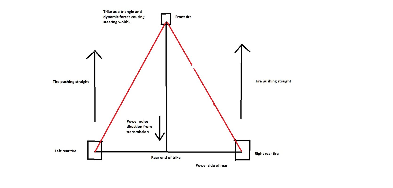

I made this crude drawing I attached to illustrate what I think is the dynamics of the steering wobble.
The trike is a triangle setup. The rear end being wider and always pushing straight. The right side on most setups is the power side that moves the trike forward. As you ride or slow down the torque pulse from the drivetrain through the rear end pushes and lets off, push and lets off. As its doing this the right side of the rear ( power ) is pushing then releasing the push. This I think is causing the wobble you experience at slow speeds or slowing down.
Other factors that I think can increase the wobble effect are
Rear end alignment
Drive belt adjustment
Rear tire pressure
Steering head bearing adjustment
Engine mount bushing wear and rear end bushing wear
Condition of the road surface ( Tire ruts, cross slope of the road for drainage )
I dont think the wobble effect can be eliminated, but can be reduced.
