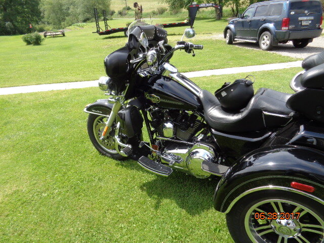

Ok while at Ohio Bike week a buddy and me got a deal on love jugs since we each had them installed,he got the smaller set on his 09 and i had the cool masters installed on my 17.Now maybe I was under the wrong impression but I thought with the installation of the cool masters that would help keep the EIMTS from coming on so much.Well coming home today it was 78 degrees and after a blast of about 10 miles down I70 at 70 mph I pulled off the exit and pulled up to the light within 20 seconds the EIMTS kicked in,is this normal or am I expecting to much.

Testing data shows that two areas that generate the most heat is when running 70+ and at a stop and idle situation and you have that combination in rapid succession. Even with the fans, you will have times where the EIMTS kicks in if you go from prolonged 70+ to a dead stop and idle as the heat will climb quickly in that situation.
I sent Love Jugs an email concerning the EITMS kicking on,i received a message on my phone from Steve from Love Jugs,his explanation makes sense now .Harley has the EITMS hooked up to the ambient air temp and if the air temp gets over 81 the rear cly will kick out.He said to disable it and not to worry the engine will not over heat.You cant beat customer service like that.

After sending Love jugs a email about the EITMS they called my home and left a message explaining how it works.Well before I could call back I started having some issues with the fans slowing down and at times coming to a stop.So I called Love Jugs and explained the issue,Dave said it sounded like a power supply issue,but if I needed anything to call him asap and he would have parts or fans over nighted to me.
Well today I got the trike back from the dealer and pulled the right side cover and inspected the connections.When they installed the accesssories plug they didnt get it lined up correctly and it pushed one of the pins back so it was not getting a good connection.Simple fix and now they work great,hats off to Love Jugs for great customer service.
