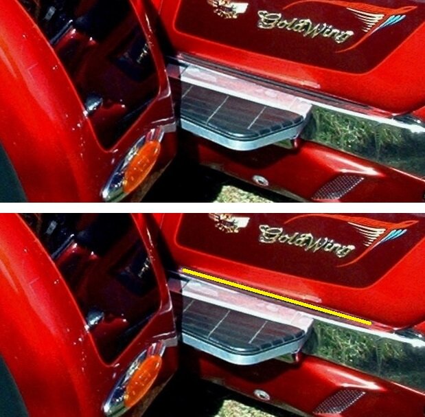

Over in the 1200 section I posted a reply about how I secure the side covers on it with a cord the runs from the rear frame tube next to shock through a 3/16 or slightly larger hole in rear lip of cover across back side of cover and out front edge to be tied off on motor mount.
Well, on our '97 trike .... we purchased it in 2004 and besides a new battery, part of the deal was they replace a right side cover that had blown off and got runned over before being retrieved. Over $400 it cost them.
So naturally, I promptly looked at a similar arrangement for the 1500 trike. The top of the side covers fit under the seat, the bottom of them has to be pulled out first to remove them. Along the lower edge of the 1500's covers is a recessed lip that is like a recess. I drilled two holes in each, one near front in that lip and one in rear just ahead of where the trike's rear fender and the bracket with those two rubbers are. I used simular cord, tied a loop and zip tied it to the trike's frame at the front of the cover, pull it through the front hole, push it back through rear hole and pulled a foot or 16" slack in it. I tied a loop in it.
In use I install the cover, pull slack to outside, reach under and pull cord behind the cover at rear to remove slack, and then found a way to lace the cord underneath and simply hook a small bungie cord 's hook in it to maintain snugness.
No one ever sees the cord as it's in a recess along the lower edge of the side cover next to pass floor boards .... and unless I reach under and unhook that bungie and pull slack back through, it ain't coming off. The 12-16" slack allows me to lay the cover up on the seat, etc as desired when servicing the trike.
I have installed new grommets, even have spares .... my covers fit as well as any. A little Vaseline makes life easier on the pegs. But at higher speeds and especially in high winds, there is a pressure that can build under the trike and it can blow the side covers off .... that's what my cord stops ...... and they may discourage theft.
To aid in spotting it, see the yellow in the lower picture.
