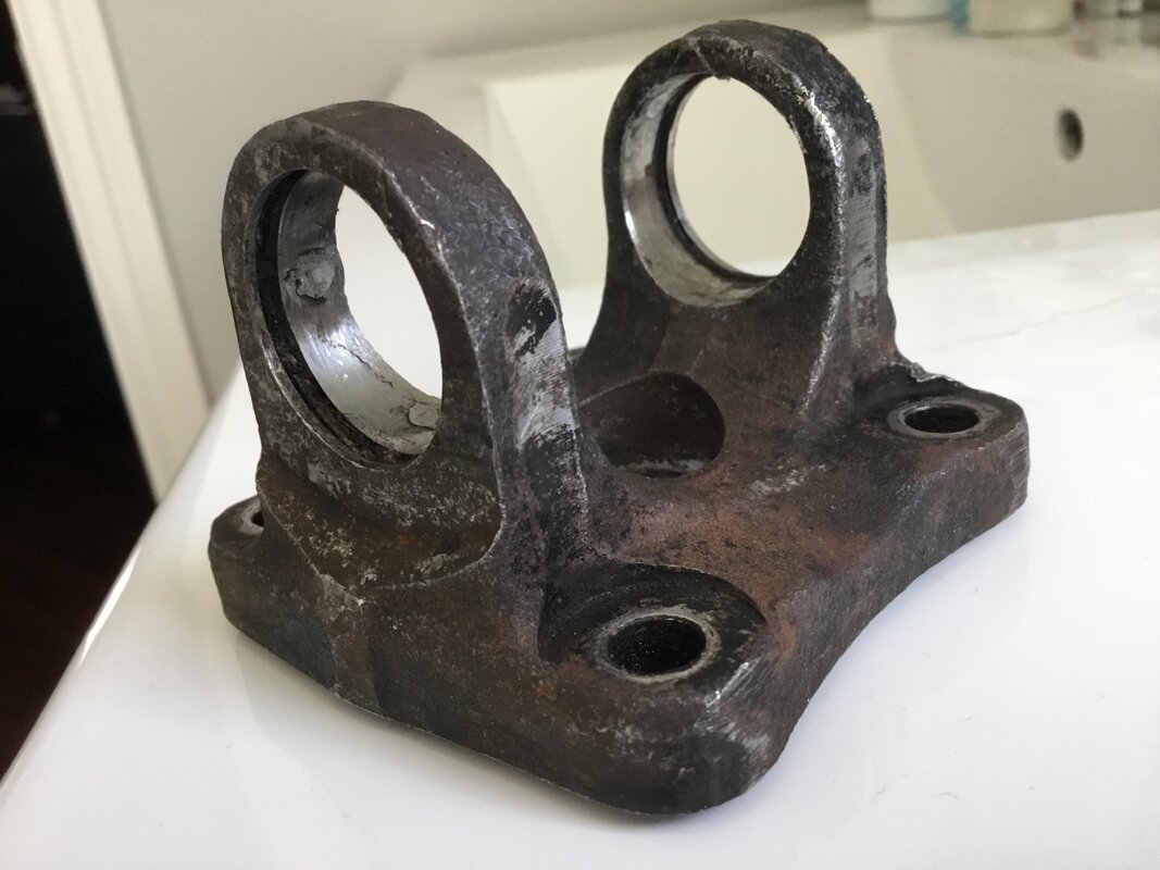

I removed the driveshaft from my 2013 Lehman Monarch LLS-ll for inspection and found that the eyes in the flanged yoke that bolts to the differential we’re streched, the caps we’re moving in the yoke.
I called Champion (who now own Lehman) and they informed me that they only sell complete drive shafts.
I understand that they are not in the driveline business, but it’s senseless to replace the whole driveshaft when you only need a yoke.
Has anyone on the board run into this? We’re you able to find a Yoke?

That almost looks like a ford yoke. Does it use a ford rear end? Maybe take it to a junk yard and match it up.
I know some folks were using the front joint from 98 f 150 on there home brew units and it would be close and definitely worth a look.Now you've give me something else to check on mine.

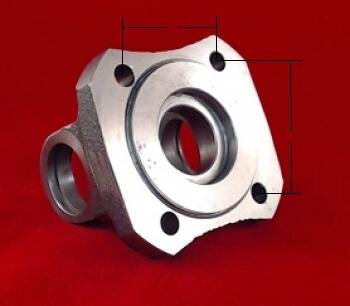

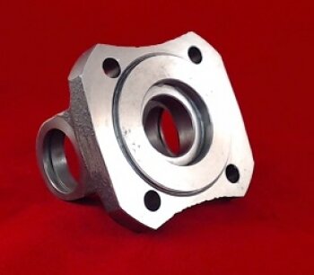

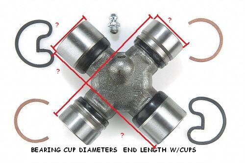

I am only interested in the bolt hole center dimension and the u-joint dimensions.

I took the dimensions of the yoke as follows
end to end dimension of cross.....2-7/16” Cap to Cap
OD of Caps......1-1/16”
Bolt Circle......3-1/16”
Spacing of bolts.......2-3/16” in both directions
Bore of Raised Face......1-7/16”
OD of Raised Face......1-13/16”
Height of Raised Face....3/32”
Outside width of eyes....2-11/16”
center of cap to face of flange...1-1/2”

The dimensions you gave for the u-joint make it a 1210 type.
https://www.ebay.com/itm/NEAPCO-N2-...ash=item46726050ab:g:mMcAAOSwJoNZvRVi&vxp=mtr
GOOGLE SEARCH " NEAPCO N2-2-2323 flange yoke".
https://www.ebay.com/itm/437-Univer...ash=item3f93b5049a:g:em8AAOSwgjFZsE9T&vxp=mtr
Some on eBay...... look at the dimensions.
Way to go Jim, I believe you nailed it.......I will contact Neapco tomorrow and make sure it has the raised face......when looking at the specs....it has a Pilot Diameter of 1.81M........I think they are saying 1-13/16” Male.
