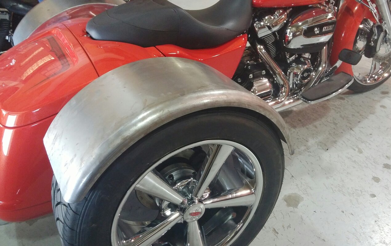

^...Not "knockin'" anyone's fab ideas, but those fenders look like something sitting on the shelf over at my local Tractor Supply!!!
In that vein, simple is 99.9% better most days...:clapping:
Hopefully once it's painted to match, it'll be a true eye~catcher!
If you can, please keep us posted on how it gets "finished", Randall.ThumbUp

I agree with that, the metal was a thicker gauge than normal and minimal at that. At least it doesn't have the bare tires anymore :laugh: we'll see
Can you get any info on the adapters they used to go from 4 lugs to 5 lugs? This pushed the tires out a bit and required the new fenders ... I suspect???
Bob :Dorag:
I'll have to check on what adapters were used next time I'm back Bob, my regular service guy wasn't there today and it was super busy with their year end closeout.
Bob :Dorag:
Its the diameter and width of the wheel/tires that required the new fenders. You can offset the additional space required for the adapters with backspacing/offset on the new wheels. It took me awhile to find the right combo after I bought the adapters. I saved a ton of money over buying custom forged 4 on 4.25 wheels though. Like $2K difference...

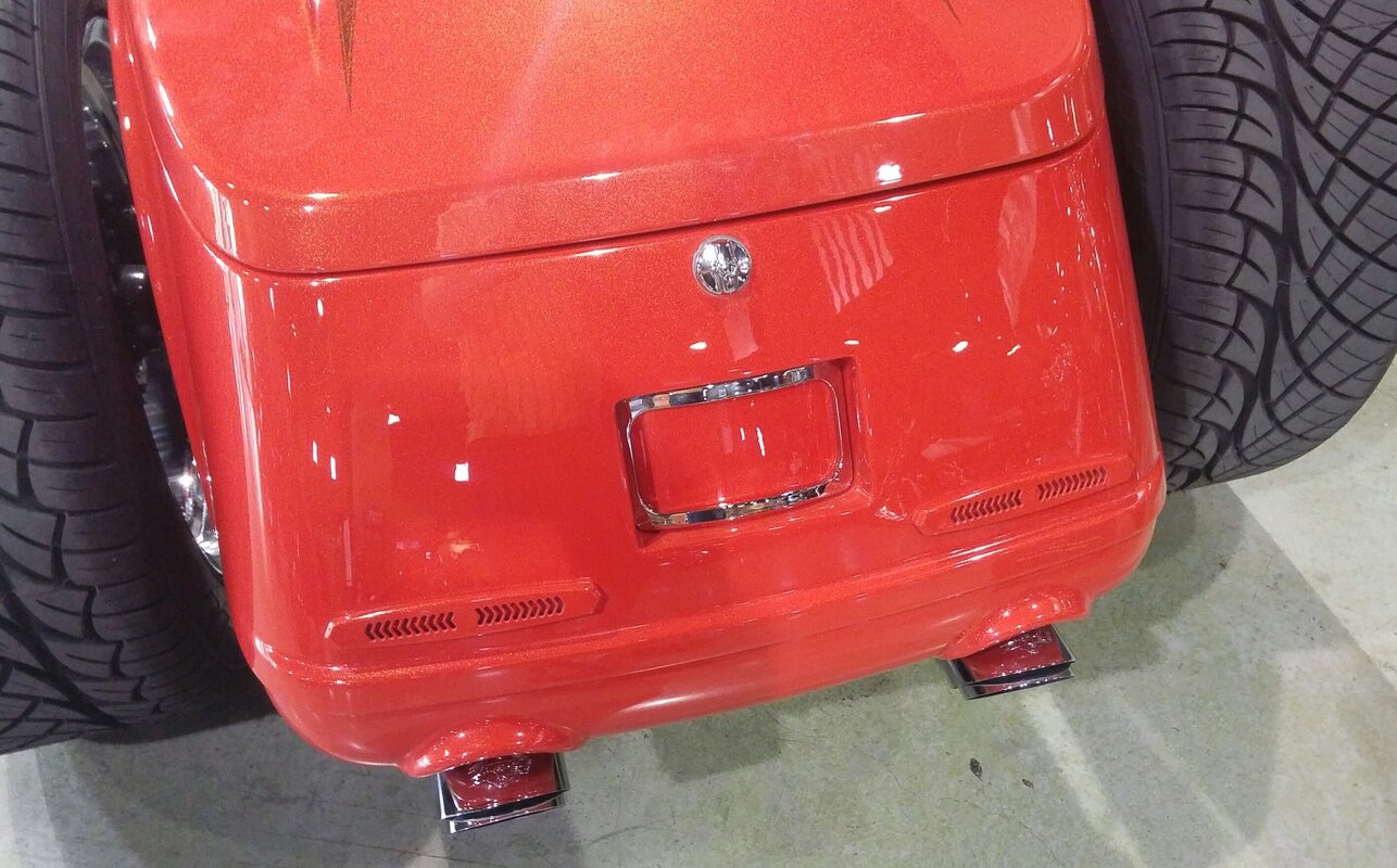

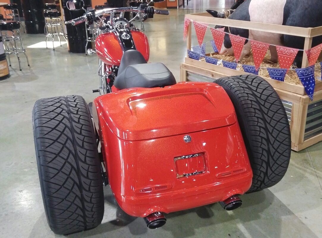

Here are a couple of pictures of the work so far on my Free. Still waiting on the custom rear fender brackets to be fabricated, the front fender, V&H dresser duals, and a bunch of other little stuff. It has been a long process, but getting close to the end finally. :D
That is Sweet!!! Can't wait to see completed pics!!! Great job!!!

While looking around i noticed that they have fabricated the rear fenders on that custom trike from previous visit ... View attachment 49055
Which shop made the fenders? Do you have any idea if they were they actually fabricated at the shop or were they purchased and fitted to the bike. Looks like they tied off on the axle and let the fenders float instead of attaching to the body and allowing travel space. Like to see more detail if it is available.
The guys at Mohawk customs helped me with the fenders. They have flat bar welded underneath to keep the vibration minimal. They shake less than the stock fenders at idle. They are attached with a custom bracket using the existing trunk bolt holes from original fenders. These pics are kind of dark... best I can do now since it is raining.

There are a ton of steel fenders like those pictured available on Ebay. You just need to know the radius that you need. You will also need to internally brace them or they will flop around like crazy.
Thanks Blake,
I have been exploring two approaches. Mounting them like you did with stout brackets and an allowable clearance for shock travel or; Mounting them at the axle assembly's attach points for the calipers so they hug can the tires (see below). My concept for the fenders is more like the ones below. They are reinforced vertically and horizontally across the aft section of the fender. But to your point, may require more. Any and all input is welcome :)
Those fenders are cool. I looked at axle mounted fenders but the ones I found had flimsy looking mounting hardware. Good luck with your build. Looking forward to seeing it.
Those fenders look good on that freewheeler. I got some like that off of ebay and radiused them to fit my tires and made struts but did not brace the under side and the strut broke and the tire grabbed the fender and sent it skipping down the road. I made all new struts out of 3/4"x 1/4" flat stock tig welded that goes all the way under the fender with 4 button head screws across it.
