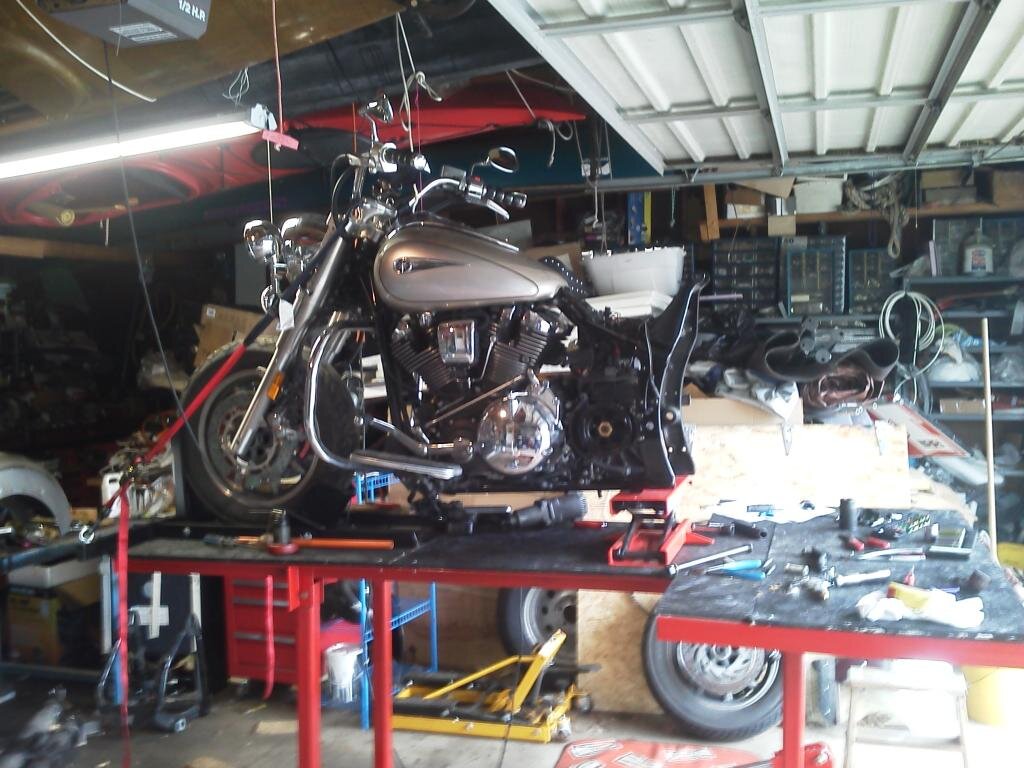

I have one I bought about 2003, used it to jack the 1200 bike, was like $90, maybe cheaper with coupon then. Larin, it's red, I think it's rated 1500 lbs? I changed out the bolts to SAE grade 8 1/2" with nylock nuts. I do use the bottle jack part alone as a jack sometimes, & I have used it to jack the mower … but never thought of this, I like it, gonna blow the dust off & try it for next oil change, maybe today even … Thank You Sir!
I kept it when a buddy offered to buy it as it would work to move a rear axle, transmission, or NP205 transfer case too with wooden cradling or blocking I think. I never even considered using it with the trike, just seemed unbalanced enough under a bike.
