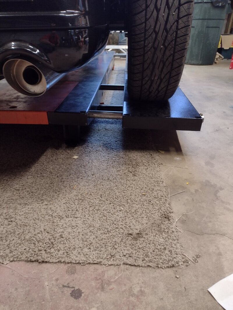

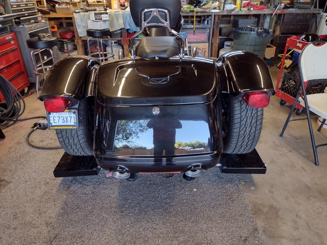

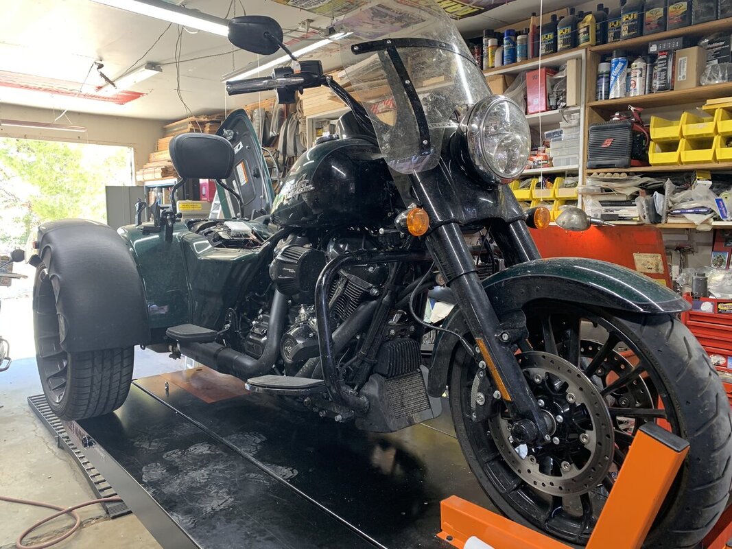

I knew when I picked up my trike last week it wouldn't fit on my Black Widow lift table. It already had the side extensions, so I took a few measurements and went down to the local metal supply house and bought some tubing to support the side extensions. I got the tubing with a little bit thicker wall thickness than what was originally there. It fits nice.
I do seem to have a little sag in the rear of the lift table due to the extreme weight in the rear. I am considering getting a piece of 1/4" inch plate to put in the rear for a little extra support.
Having a lift table is certainly a game changer if you do your own work on your bike. Todd

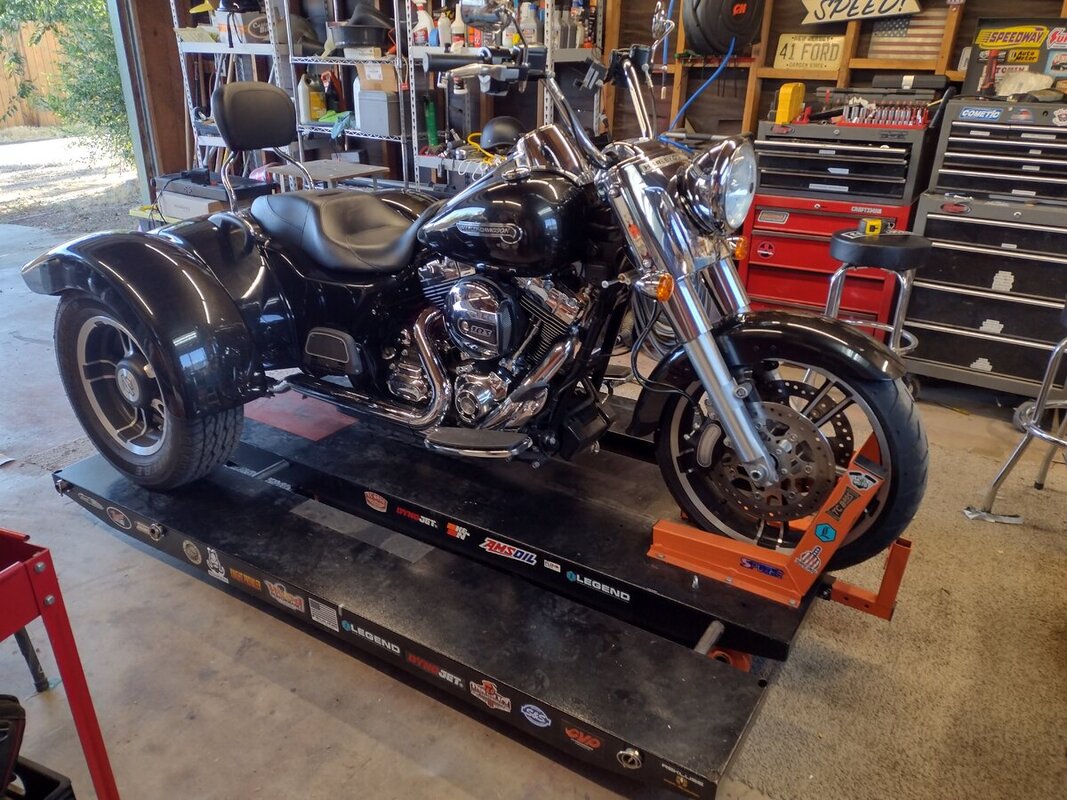

I had the same lift table and used it numerous times until I converted my bike to a trike. And same thing, it was no longer wide enough for my trike so it just took up space in the garage. I ended up trading it for some work I had done in my kitchen. I wish I still had it. You came up with a very creative workaround.
