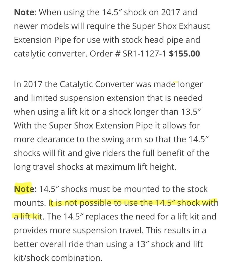

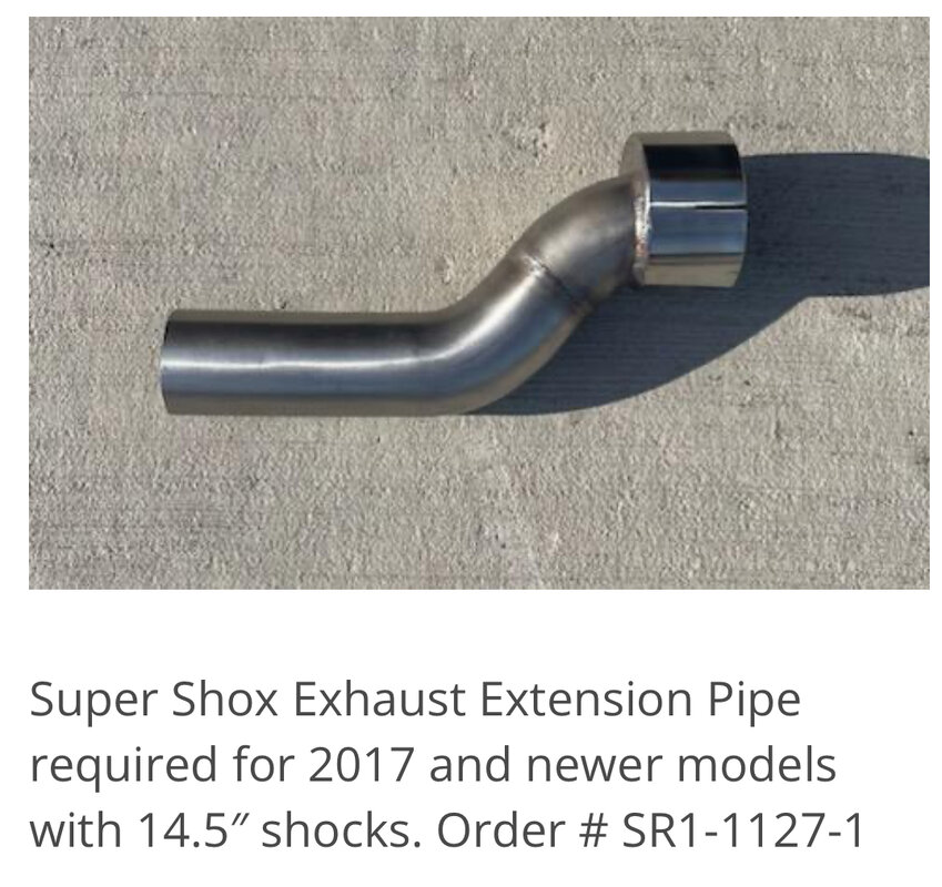

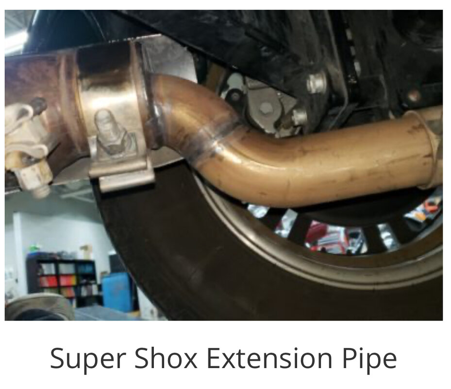

Has anyone installed 14" shocks and lift kit on 21 and newer Triglide , and found the catalytic converter hits the swingarm if you try to get it higher than stock. Super Shox sells a modified exhaust pipe from the cat to the muffler which allows more clearance. Has anyone installed this part and does it increase clearance for this purpose?
For 2017 & newer trikes, I believe their modified crossover pipe is designed for 13” shocks (with lift kit bracket)…. OR if you choose 14”-14.5” shocks (no lift brackets).
You do not want a 14”-14.5” shock added to a “lift kit bracket”. You will already be at your maximum height and no one recommends combining the two.

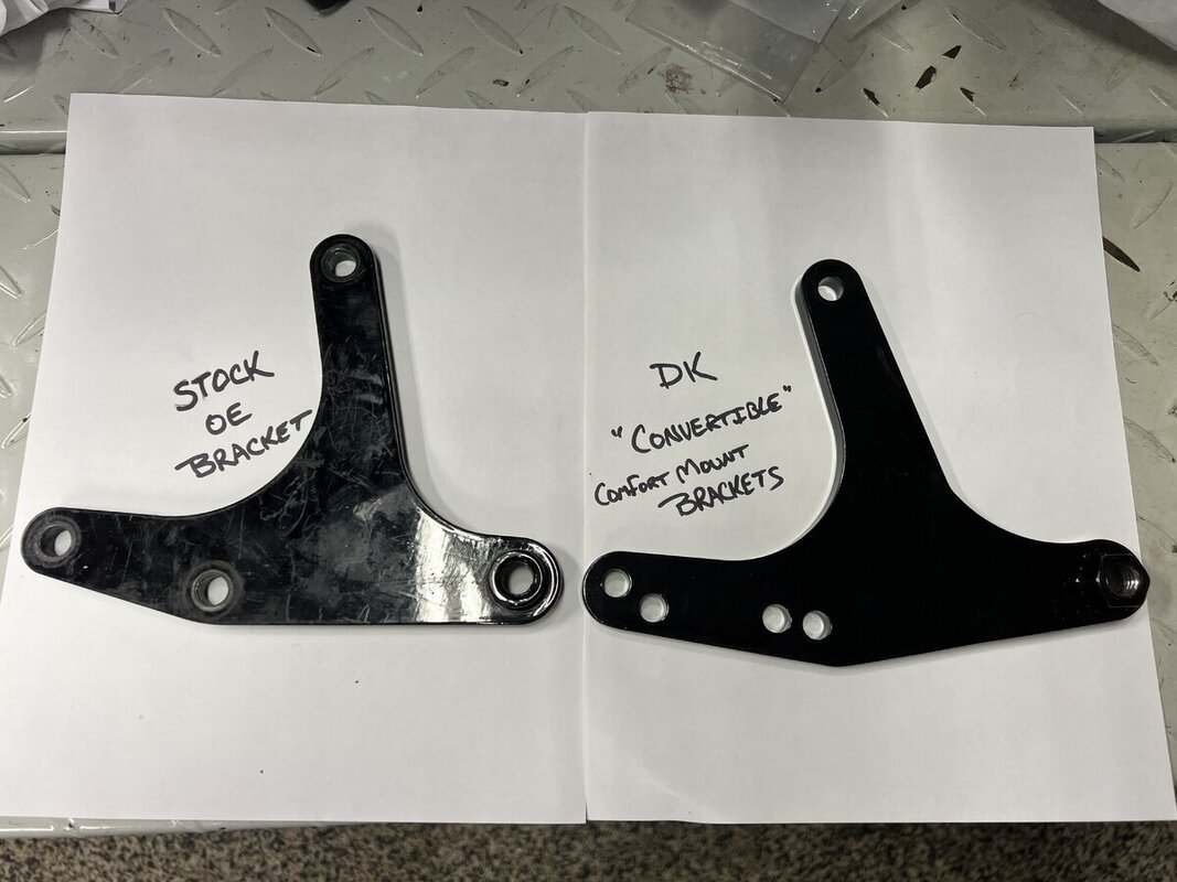

Now… with that said, @DK Custom Products does make a set of brackets designed JUST for 14” tall shocks. These “convertible comfort brackets” do not add lift, but instead kick the shock back just a little more angle, which the end result helps add slightly better ride quality due to the added angle of the shock. Again, it does not add lift… just angle.
Hopefully Kevin can add some info and if any experience with their shocks and also the necessity and fitment of this modified pipe …. and what they recommend with their shocks.
Getting back on the modified exhaust from Super Shox… again, it is NOT designed to be used with the combination of 14”-14.5” shocks and a lift bracket due to clearance issues, which they state that in the product description.
EDIT: Many others on here (and other groups) have newer Trikes and added 14” shocks without the need of this pipe.
Not sure why there is an inconsistency as the need for this modified pipe. ????

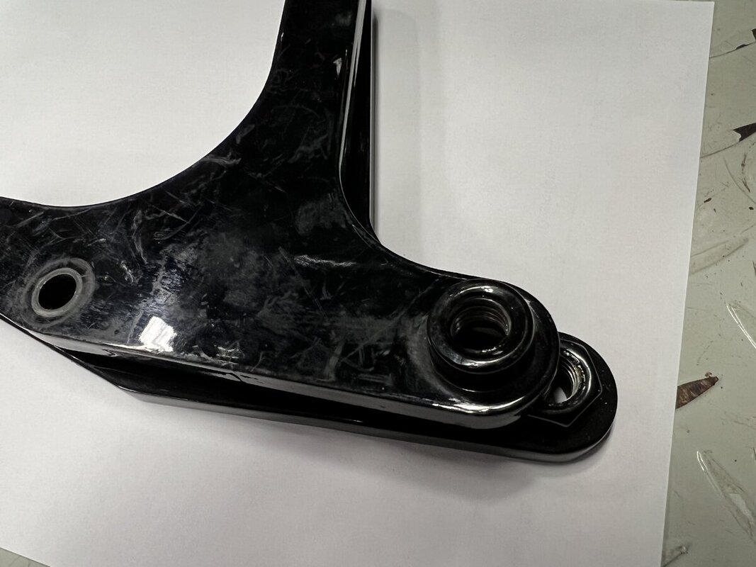

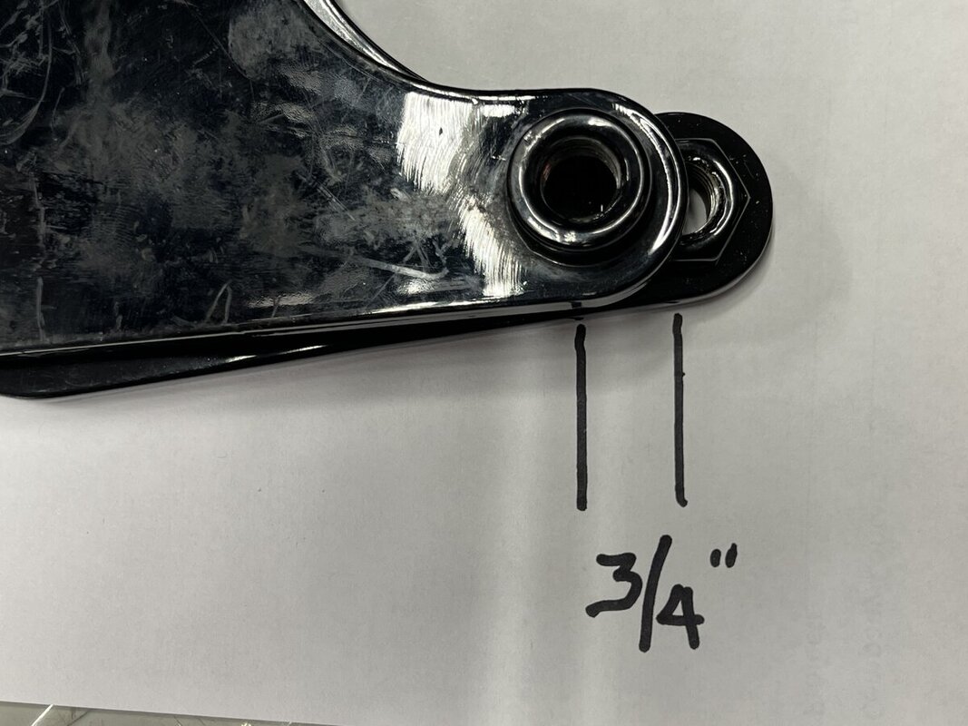

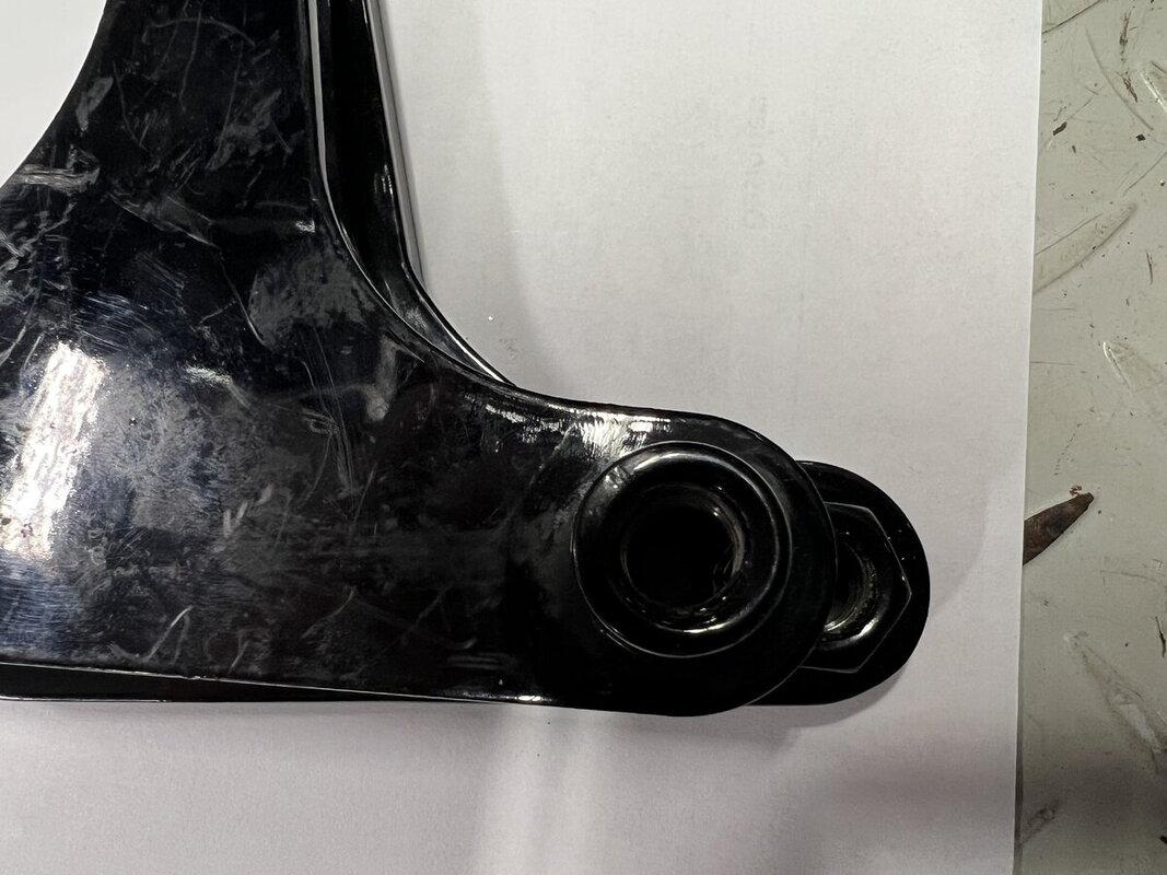

I purchased those brackets and the only difference is not height, but actually the shock will just kick back a little (as far as they engineered to fit without obstructing/hitting) and it’s only 3/4”. (Which that angle should actually help - how much??? … that is the question)
That’s the reason I made that thread. Stay tuned on that ….. when I have a chance to get them installed and I may even do a quick video on my final result and my thoughts.

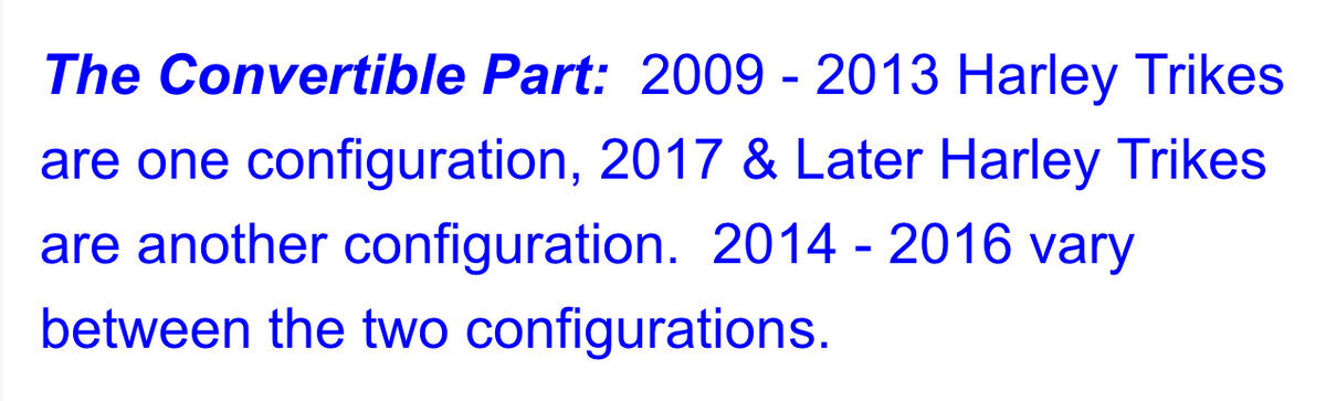

Here’s pics of those brackets compared to stock OE brackets:
Now… this is where I personally do not know the differences are, and as listed on the site:
I have a 2014…. You said you have a 2021, so that’s where I don’t know the differences???
If I recall correctly, the bottom OE shock bracket is the same unchanged part number from Harley.
So hopefully others can indeed chime in to see if they have a similar experience or situation.
