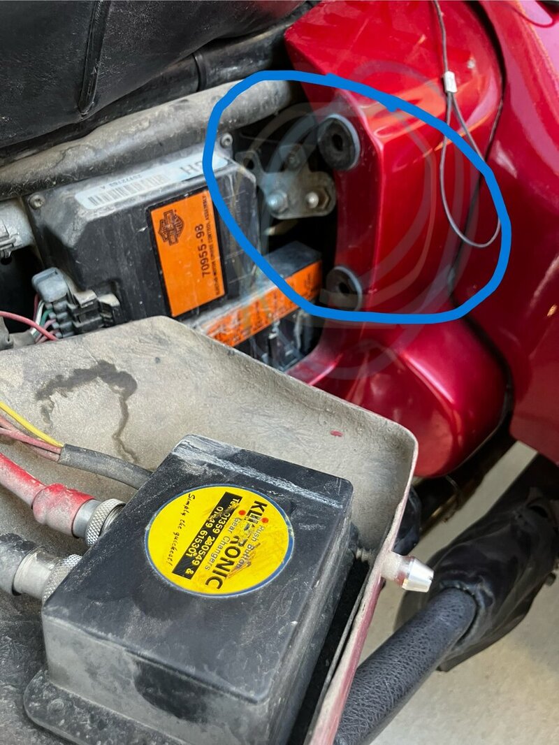

I have a '99 Ultra with a Lehman Renegade and i cannot for the life of me find where the air shock fill valves are??? I dont see good and looked the other day underneath to see the airlines... Can anyone tell this dumb Norske where to look?IMG_2164.jpg

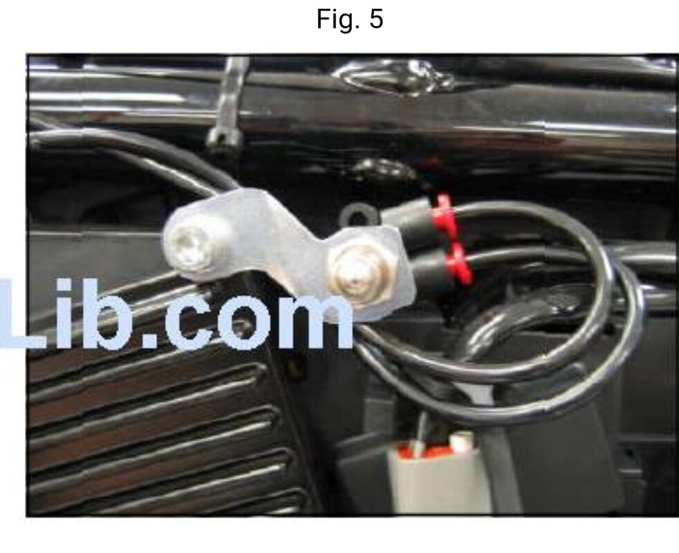

I found this info on page 21:
See Fig. 5. Air valve plate for front and rearshocks must be relocated. Recommended loca-tion is on right side of trike behind top bolt onelectronic control module. Re-route air lines to fit
found em, they were under LH cover behind the elec shifter control module but i dont find any
