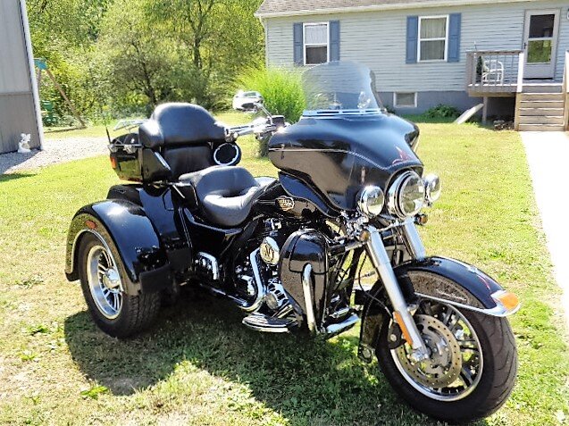

I installed Phase 7 headlight and passing lamps last spring and we love the them ThumbUpride safely fearless
2004 - Will they fit?
My trike is a 2004 CVO...will these fit the older HD? I was wanting to go LED but sure did not like the HD price....this looks like the way to go.
The passing lamps should fit size-wise, not sure about the plug inside the housing, but that's easy to work around if it's different. The headlight should be plug and play, has the standard 3-prong headlight connector.
Cool!
Thanks for the info. A little solder and heat-shrink tubing and I can make it work.
