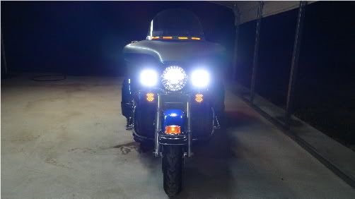

I have the LED HD headlight and the passing lamps. Huge difference on how the lighting is at night. I would recommend them if you dont look at the price.
I havent seen any fogging in the lights
I got mine from Zanotti Harley. Best pricing I have fpund so far.
I love the LOW beam pattern on mine. The high beam is ok but the lows are all I need. The driving lights improve the front end look and visibility for oncoming cars.
I have them and they are great. My friend has the K brand and the light amount and pattern are not up to the HD brand neither is the price though. This time I think you get what you pay for but not always. Thanks, Jerry

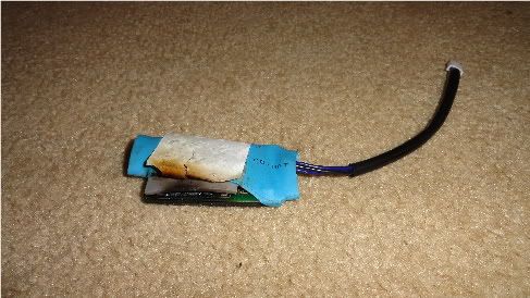

I had the Kuryakyn Led Headlight with Lighted trim ring, Running Lights and Turn Signals installed by Kuryakyn at Thunder Beach. I can't advise on how they compare because I just got the Trike back from the shop. Long story. Anyway I would like to advise you that If you have the lights I had installed and you have a Factory Security System you may have to have a Load Equalizer installed also. That is no big deal but what is a big deal is you cannot run your emergency flashers. If you do you will BURN-UP the Load Equalizer(Ask me how I know this?):( I was not informed of this when the lights were installed although this info is listed under the Load Equalizer on their web site. Anyway I called Kuryakyn and explained my Load Equalizer had burned up and that I had NOT turned the flashers on. Well it seams what happened was I had put the Trike in a trailer and while it was going down the road the flashers were being activated by the security system when the trailer hit bumps in the road. They advised to always put the Key Fob on the bike when trailering. Kuryakyn is sending me a new Load Equalizer NO CHARGE.:10: I did suggest they might want to re-design their Load Equalizer :)
I did a search on The HD forum and found I'm not the only one with Load Equalizer problems. There is one that says it can be used with the flashers without a problem so I ordered one today. Comes with a 30 day no questions asked return and a Lifetime warranty so I said what the heck. Will try it and see what happens. Sure will be better than worrying about the flashers. here's a link if anyone is interested.
http://www.biketronics.com/products/BT-801-Smart-Equalizer.html#reviews

I have a badlands load equalizer and have had no problems to date..I bought it more for my LED tail lights and for my Trailer.
