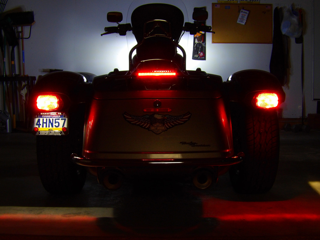

I use Sylvania super bright 3157 R on mine https://www.sylvania-automotive.com/products/interior-and-exterior-bulbs/zevo-led/3157r_zevo.jsp
You will probably throw a code, do not panic. Clear the code, then turn on 4 way flashers for a couple of minutes. This gets the can bust to recognize the voltage difference
Do this before starting the bike, this should stop it from throwing a code to begin with.
Turn the ignition on
Turn on the hazards
Turn off the ignition and let the hazards run for 30 seconds or so.
Turn the ignition back on
Turned off the hazards
Full LEDs.
