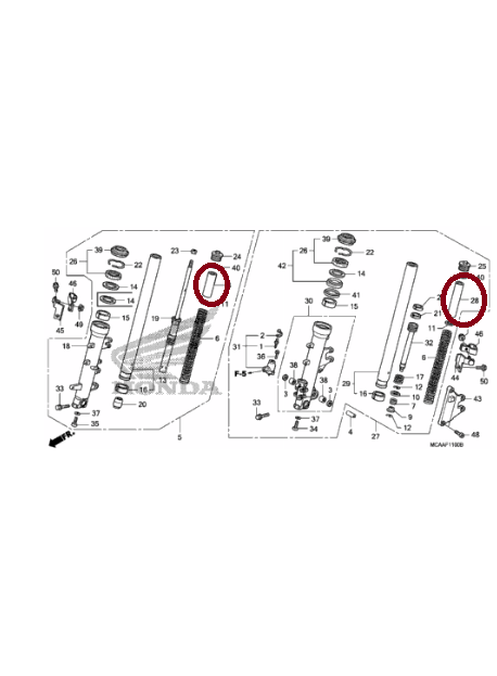

So tore front forks apart and to my surprise no progressive springs (Trike builder said he put them in ) What was in there was a 2" extension at the top a 6"spacer and a 12 spring (probably stock ) So ordered progressive springs which is 18". So I guess the the 6" spacer goes away. waiting for springs and instruction.
Doug, IF you don't mind my asking; who did the conversion? What were the "spacers" actually made of? The reason I'm asking is that sounds exactly what was in my shocks when I had to rebuild em. I sent Papa Zook pics of em once I had em apart, and he was pretty amazed by it. Feel free to email me, if you'd rather not post that data on here. Email: ljohnson@ivfservicesllc.com
Not sure I understand Marc, are you saying that Greg's information is incorrect? Just trying to be sure I understand your comment, that's all. Couple of years ago I had the traction springs installed in my 2005 GW, 2012 RS front forks, I think it was the 1.0 spring, not sure......Bottom line here is, it was as rough as a logging truck after the install. My installer said it was done exactly per instructions, he actually tore it down to ensure it was to tration's specs. He replaced them with OEM Honda springs, so all is good now. Not critical of Traction because they work for a lot of riders, just didn't for me. Just so ya know, Traction was very understanding, I returned the springs, the returned the cost.
He didn't like the adding of spacers.I agree.I did Racetech on my 1500 and I have played with scaper length a bit getting like I wanted but they have always rode better than the Progressives I took out.That doesn't exactly apply to this discussion since guys have 1800s.
If it is a stock fork assembly, it has a stainless steel tube (spacer) on top of each spring. They are different lengths for left and right. That is a spring spacer.
