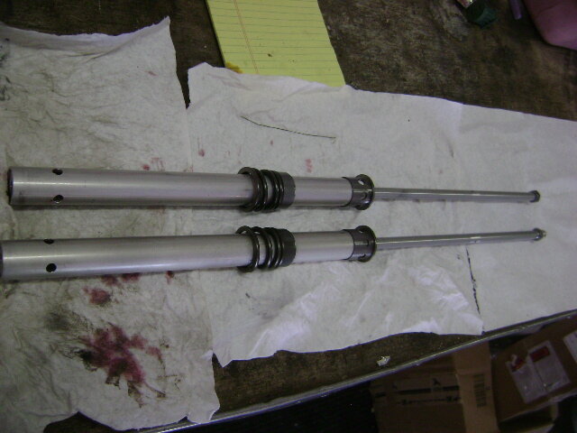

The disassembly and cleanup went well.
The left fork re-assembled perfectly.

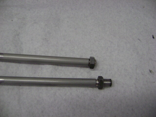

The right fork was not so good. The damper assembly broke during the assembly process. I threaded it into the end cap and as soon as I began to snug up the lock nut it broke right on the threaded end.
I contacted Partzilla and ordered a replacement assembly and a day later got an e-mail that the part was on back order with no idea when it would be available.. So my internet search for another source began with no luck finding the part anywhere. I then started checking motorcycle salvage businesses and found a part in Georgia. It arrived yesterday and the trike is now back together and tested out just fine.
