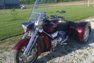

THE TRAILING LINK ON MY TRIKE RIDES REAL NICE. YOU SEE THE SHOCKS MOVING BUT YOU ARE UNDISTURBED. TRAIKING LINK ALSO HAS A BAD TRAIT AND THAT IS RAKING. IT WONT HAPPEN JUST BUY A STABILIZER AND KEEP SMILING I HOPE THIS PICTURE COMES THROUGH.
