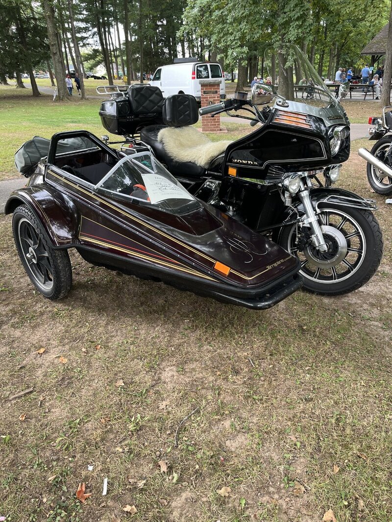

Morning, any one out there know where I can find a leading link or raked triple tree set for my ‘83 Wing?
Not new! Those are more $$$ than my whole rig.
Where do old trikes go out to pasture?
Maybe a set laying around?
Would consider whole project bike collecting dust with a set.

That's a very fine rig you have there, Rick and in amazing condition! Yes, adding raked trees to it will drastically improve the handling. I used to sell and install sidecars, Champion, Hannigan and Velorex, but over the years, as the popularity and demand of trike conversions grew, I quit doing them.

The Terraplane is a fairly light rig. If you're using one hand at 60 and have a steering problem, I suspect the alignment is off slightly. In your picture, the rig wheel caster looks off. What is the suspension for the rig? How much adjustment is there?

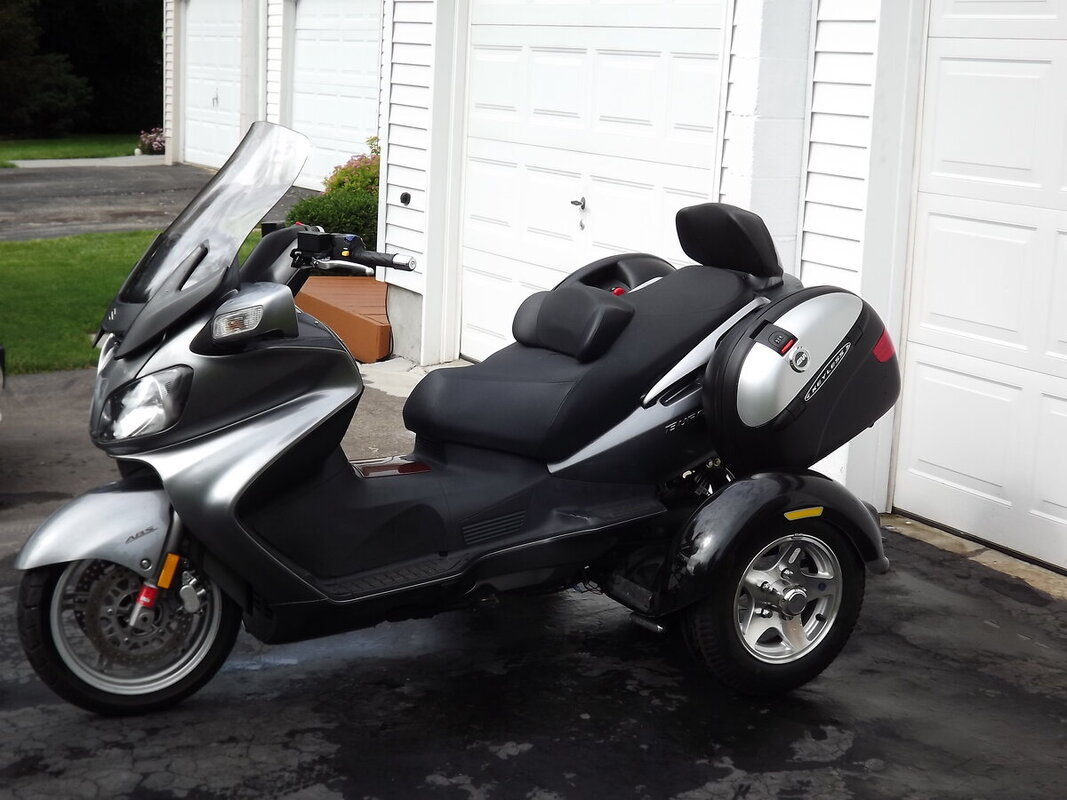

My other two bikes, the tree was purchased new. 2000 Valkyrie Interstate and 2009 Suzuki Burgman 650. The Valkyrie had a slow speed handling problem. It would pitch during parking lot maneuvers. The rake solved that.
The Burgman is my wife's, and it was for the Tow-Pac trike kit.
