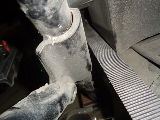

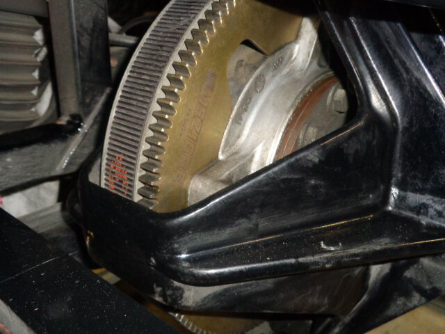

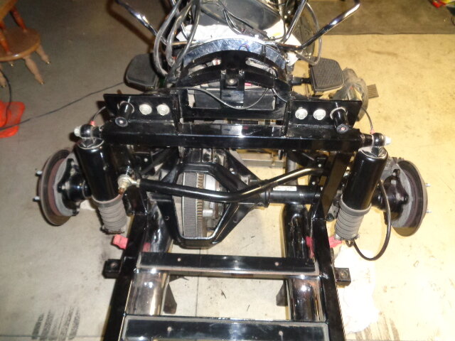

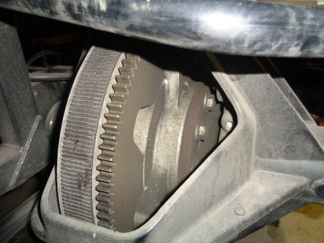

I mean the front pulley change was one great improvement for power and using 6th gear at all. But I was under Old Shiney this afternoon, and the drive pulley is riding the Differential side of the rear pulley. It is really tight and wearing the side of the belt. Either something has shifted or the re-adjustment of the belt after pulley change didn't get checked as it should have. I plan on removing the body and do a complete realignment/adjustment of the rear axle making sure nothing is loose or out of place. I am going to stop by the Harley shop and ask a few questions before I open the tool cabinets. I may even purchase a belt tensioner gage. I will be stopping at Lowes Hardware and pickup two magnetic Lasers to assist in the alignment. I plan on doing step by step pictures, I have a 09' Triglide supplement to assist in the project. this should prove to be interesting to say the least, and of course I will be compelled to clean everything that has been covered for 10 years yeppie. :Shrug:Wrench safely Fred

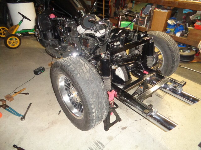

Called New Castle Harley talked with service manager, he said they could align the trike and gave me a price not crazy numbers. He asked me if I had a place in a garage to work of course I do. Do you have the supplement Yes... Lateral alignment is not rocket science I told him no problem I will handle it he did say if I have problems give him a call and he would help me resolve the problems. So this afternoon I removed the body from old Shiney and let the light shine on 10 years of dirt and dust wow. I did find out that the rear end is out of alignment laterally close to 3/16" and off 1/16" on the Adjustment bolts for adjusting the belt deflection. These distances may seem small but the belt is hitting the battery box occasionally from the rub marks I have pictures I will post later I feel confident that these adjustment will fix it. From the looks of the drive belt is seems fine with no loose edges I will measure width to be certain.:D More later Fred

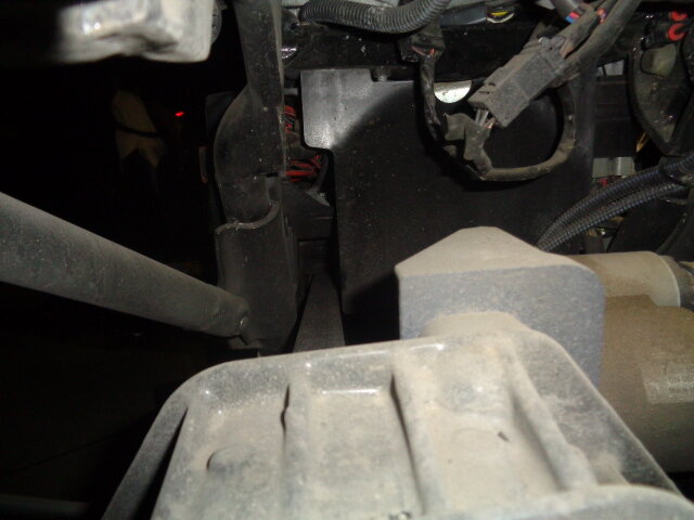

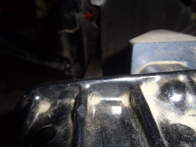

The real reason is the battery box marks from drive belt and belt krud on rear pulley on right side only

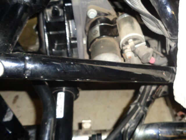

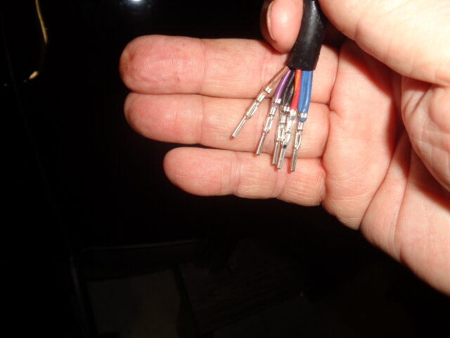

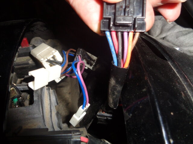

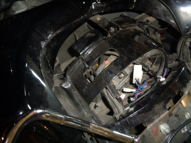

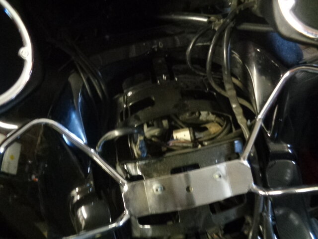

As you can see the reverse motor gets dirty over 10 years. I also found a connector that was broken and someone just inserted the pins in the other half of the connection not going to work for me, tour pack lighting. I have ordered replacements connectors as well as new brake pads. I believe I have skinned every knuckle and ripped each fingernail cleaning the frame and other parts, it will be worth it when complete. :good:travel safe Fred

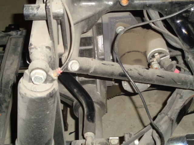

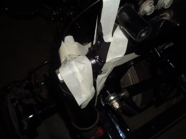

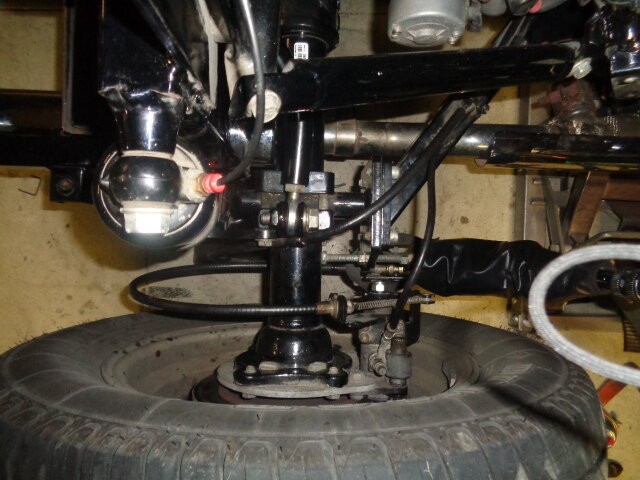

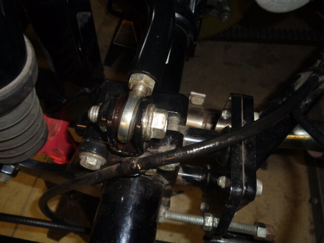

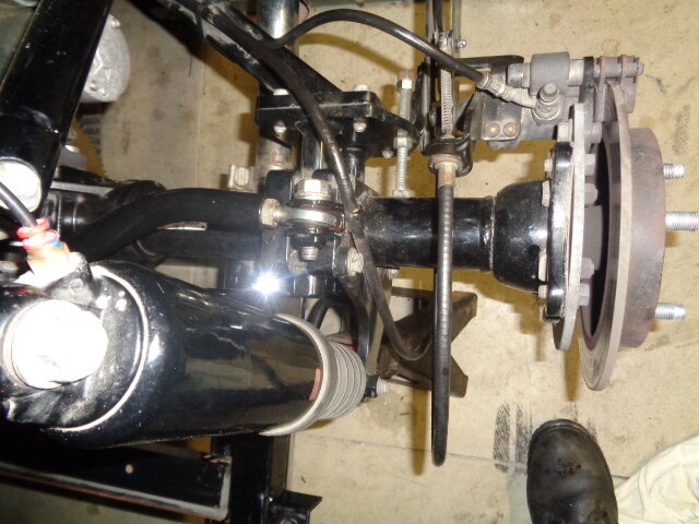

I had to remove the axle end to make a lateral adjustment and guess what I found a loose Heim joint so I replaced both just under 40 thousand miles. Drive belt now runs in middle of the belt opening between the battery box and the frame. Fred

Fred, could that have been the root cause for the belt to track as it did?

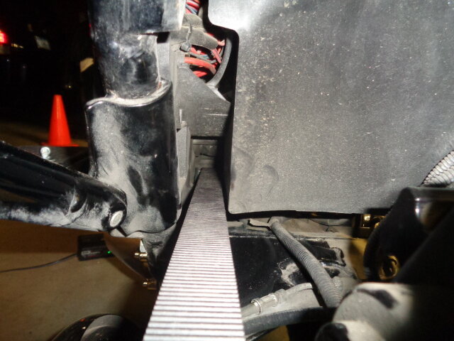

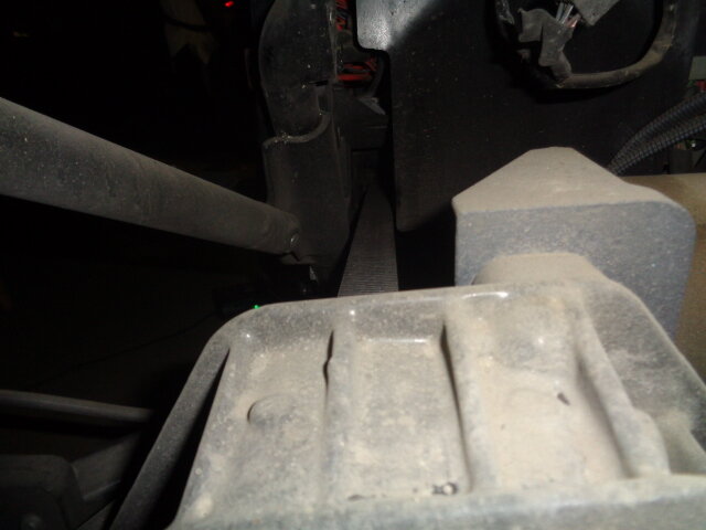

No I don't believe so thinking back old shiney did not have the tire clearance on the right side it had on the left. It will be interesting to see if the spacing is closer on the fender clearances after moving the entire rear drive assembly to the left to get the drive belt centered. This whole process has been very interesting to me and certainly not rocket science. Anyone that can measure and read the Triglide supplement can do these adjustments. not the best picture but it is almost dead center. Now just remove each one separately and lock tite them all 16 bolts.

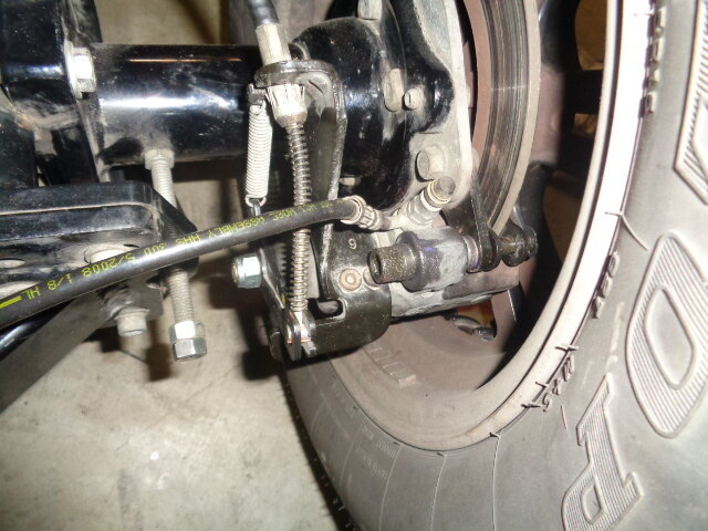

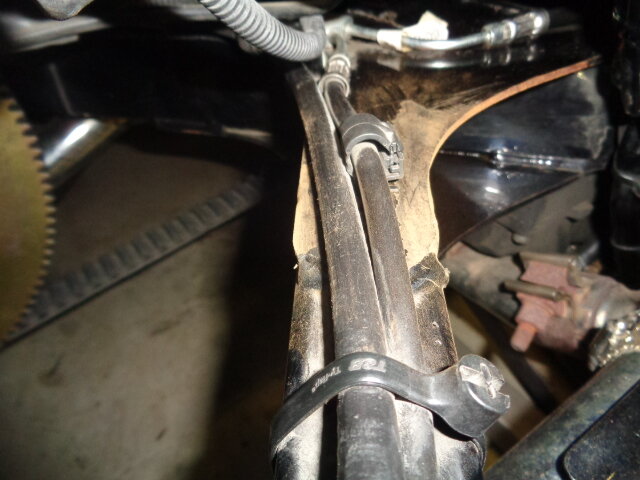

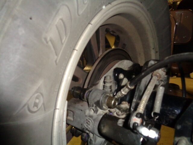

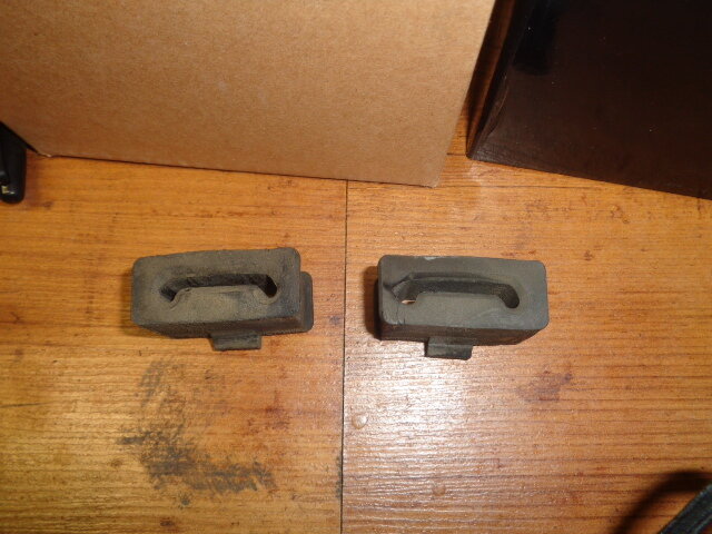

New brakes are on old pads were shot, easy swap out on brakes. The parking brake took a little thinking I had to read the book twice to get the drift must of had a senior moment oh well it's done now. Drive belt looks much better than before. Installing body Wednesday with old Friend and a new Triker an Old Road Dawg if you will old Co-worker LOL. Replaced the rubber mounts for exhaust old ones were shot

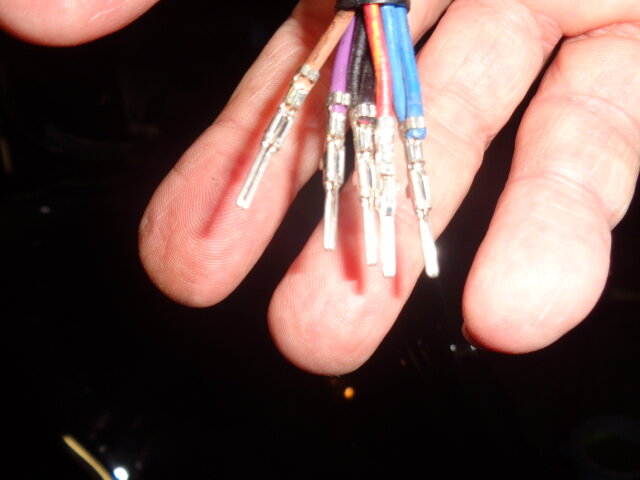

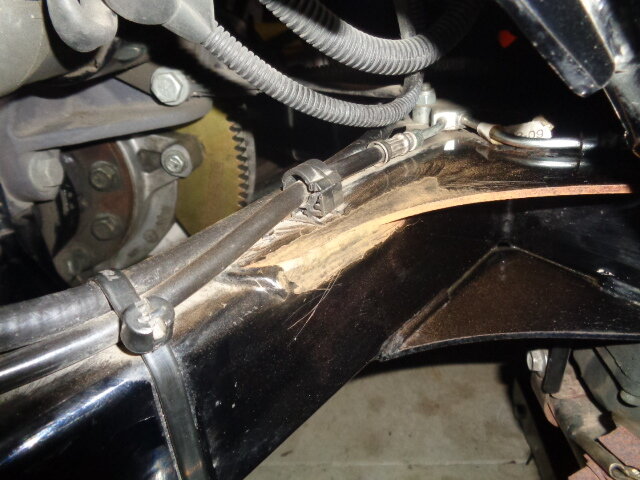

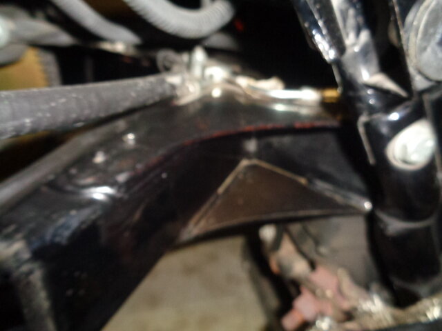

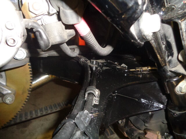

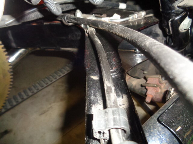

Tonight I began to look at the swing arm rust spots close to edges and welds,most likely will move lines and cables. I have a little work to do in a few areas. I noticed one insp sticker on a part dated Sept. 2008 this tells me close to assembly date. The six wire plug that was missing I am ready to reinstall the wires but the two ends don't match quite right, plan on redoing it the way it was taken apart should work, the diagram in the supplement is not really clear about how these wires are. It seems I have an orange/white stripe on trike side and no orange/white coming out different to say the least. Any suggestions?
Adjusted Drive Belt deflection needed to get a gauge to do it so I purchased one. Primed and sealed the swing arm spots where powder coat failed and also the top of shock mounts at welds where the coating blistered. There were also two areas on top of the angle iron mounts for the stiffener bars the coating failed. At Ten years old there are bound to be issues here and there. Possibly the body will go back on tomorrow, I just need to get two 12" extra heavy duty Zip ties the brand used by Electrical services those are what is used from Lehman or so they told me.

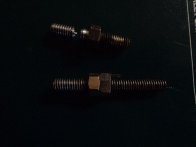

I torqued the body bolts today and the ground bolt broke it was over torqued sometime before, last bolt to finish putting the body back on. finshed painting and secured brake hoses and emergency cables to OEM placement. Wheels are cleaned and clear coated ready to go. DSC01158.JPG I plan on cutting it to length degreasing and red locktite the all thread and using it... any thoughts only 12 Lb. torque on it.
What is the diameter of the bolt?

Jack it is 5/16's torques to 12 lbs. Ground on the top left body bolt and the ground web goes there also. I'm sure it will work well thanks for the chart ride a few miles for us next time out. Fred

This project started as Clean the wheels on the inside and went down hill from there. Aligned the rear end straighten up the entire assembly, now there is equal spacing from the fender and tires on both sides. Purchased a Drive belt deflection gauge tool to make sure it is adjusted correctly. Finding the wiring mess that needed a male side plug not stuffed in the other side. I had never looked down in where it was placed all taped up, 2.50 cent plug fixed it. Found a loose Heim joint replaced both of those. I found small rusty spots where powder coating failed repaired those as well. New brake pads may as well do them while it so easy to get at. Adjusted and set the parking brake Also changed the rubber mounts on the mufflers in the rear, again very easy to do with body off chassis.
