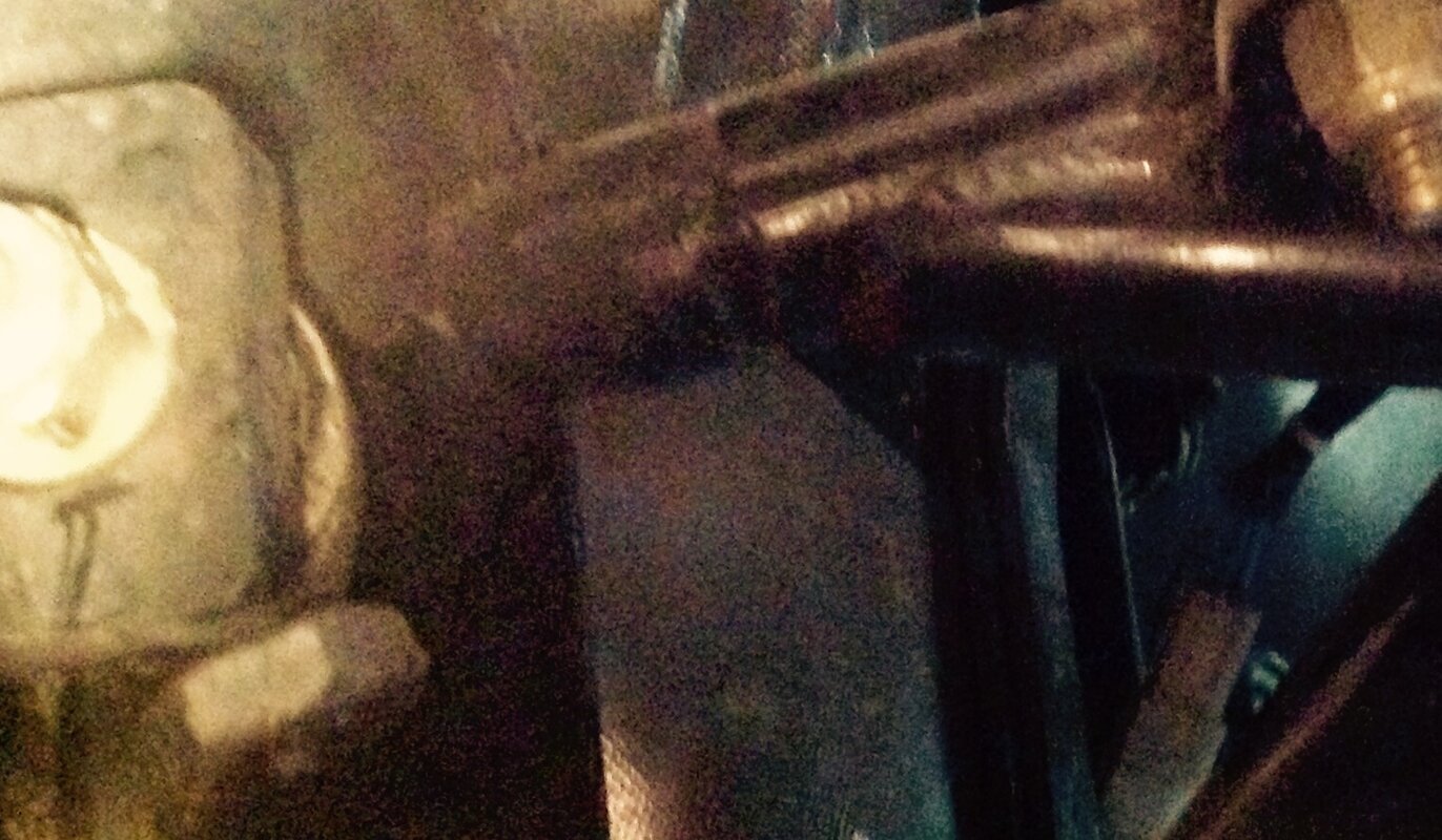

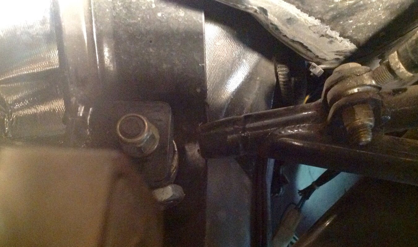

My rear support broke on my 2010 Stallion...
i think you call it a ladder bar support.....(there are 2 of these ladder bars, one per side.)
(TBMS said I need to send pictures of the break....I did....more frame breakage....31000 miles....image.jpgimage.jpgimage.jpg
That looks like the new style. I thought it was only the old style with the heim joint up front that broke.
2010 model....snapped at weld I think...
I left a light, noticed steering was turned toward 10 o'clock....I thought I'd better pull over and check it out...touch the brakes , reared wanted to pass me....woe....towed home...

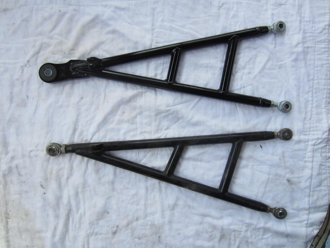

The upgraded ladder bars that TBMS came up with completely eliminated the heim joint. The whole affair is welded, there is no adjustment on that end.
Maybe you found some heim joints that are better quality than OEM and won't break. Good that you got it on the road again. Below is a photo of the old and upgraded ladder bars.

That is the heim joint. That is what broke first. The same place mine did...13,000 miles.
