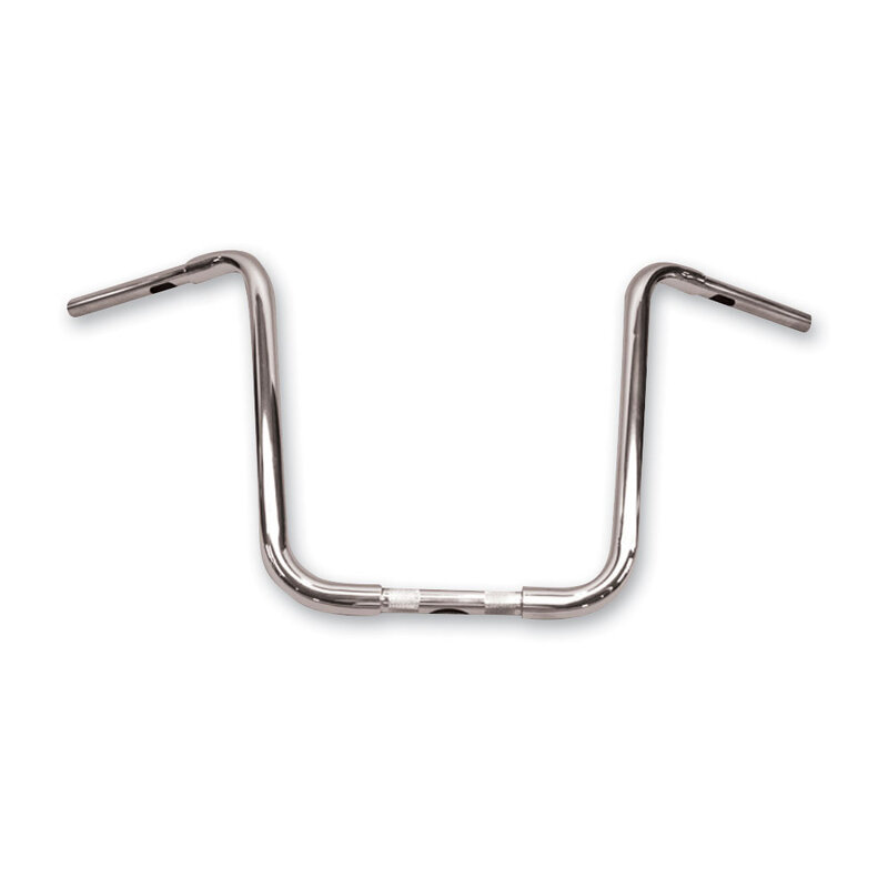

Setback, the handlebars arrived and the box was all busted up and open. They seem OK but I also noticed the bars don't have laser cut holes as advertised on J&P Cycles. I know I can cut the holes myself but I paid for cut holes. Also disappointing is I placed the bars against my stock bars and the curve on top of the bars hits 14" but the bars are bent downward at the grips and it's pretty close to the same height as the stock 12". I'm not happy and sent J&P cycles a message. I haven't heard back yet but they probably won't be back in the office til Monday. So I plan on calling them and I might have to spend more than I wanted to and get different bars. Everytime I try and go cheap, I get what I pay for as the old saying goes. So now I think I'll send these back and get the ones I really like, the KST Kustoms 1-1/4" Polished Mayhem Handlebar. (below). More money but screw it, I want to be happy with the bars. So as soon as I can get the new ones and they arrive without any problems, I'll start the install and keep you posted on the progress. I might try and film it, I don't have a camera but I might be able to do it with the cell phone and edit out my cursing and throwing tools across the garage. Just Kidding. 692-264_A_V1.jpg

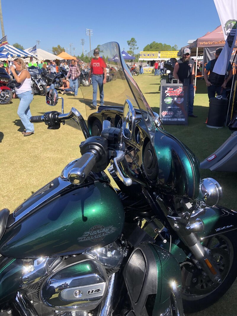

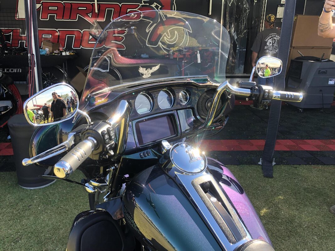

I've got the Mayhems on my 21 Ultra TriGlide and absolutely love them. The Fairing Exchange did them in about an hour at Panama City Thunder Beach Rally . I think it was 700 or 750 total. I dropped a lot more as I did sound and painted inner fairing too. The Fairing Exchange is a quality reasonably priced operation. Look fantastic and handles sooo much better than stock :clapping::clapping::clapping::clapping:
View attachment 107958View attachment 107959

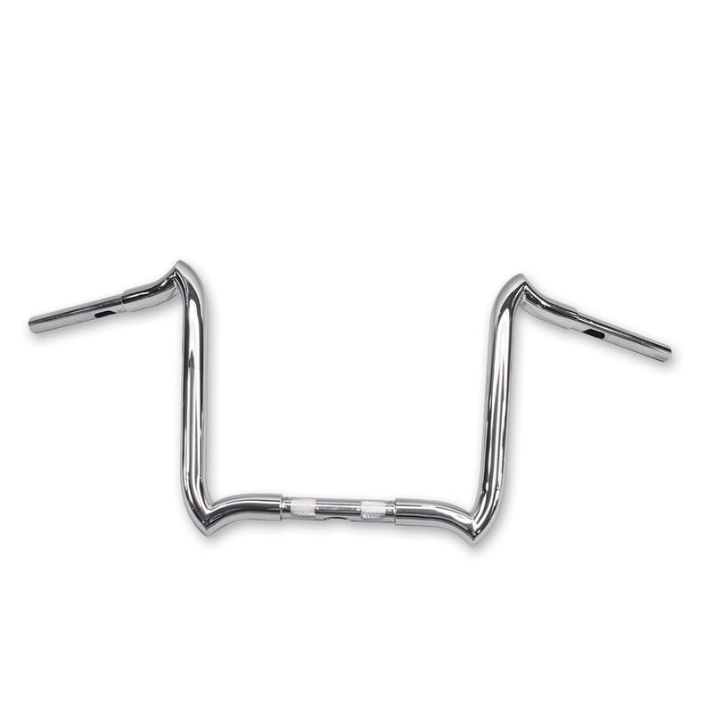

Awesome! They look great. My Mayhems just arrived last night. I'm going to try and get started today. I'm a bit pissed at J&P not only for sending the wrong ones at first but for taking so long to post their Memorial Day sale. If I waited a couple more days to reorder the the right ones after the return, I would have saved $30.00. Oh well. I saw a Tri-glide getting handlebars at thunder beach this year but that was at the KST tent. I was thinking on paying them to do it but I like tinkering with my trike so I'm going to give it a try myself. If I screw it up then I'll pay.

So much for easy install. :jumpy: Everything was going great, then I placed the bars where I wanted them and since no one was home, I attached bungee cords to the open garage door and hung the bars over the trike. Then I tighten them lightly to hold in place. That's when the first problem happen. The Mayhem bars have lower meathooks and they looked awful low. So I placed the chrome plate back on the trike and they hit the plate. But it wasn't real low, I made a little indentation so the tips fit and you can't see it. So solved that problem. I would suggest getting the handlebars without the lower meat hooks, I forget what they call them. Problem #2, I plugged everything in, put the main fuse back in and turned the ignition switched. Only the lights came on. So I unplugged everything and plugged it back in, no change. So I started over. I'm thinking the wires might have ripped while pulling the wires through plus the cut out holes are rough and might of shredded some of the wiring.. So I pulled the wiring out and found several frayed areas and cuts but not cut all the through. So pulling them through must have shaved some of the coating and it also looks like I might have cut some of the wires when removing the wrap and didn't notice it earlier. I patched the wiring and the heat was getting to me so I called it a day. Today Sunday the 29th, I plan on seeing if my patch work, worked and I'm going to place electrical tape around the cut out holes for a smoother pull through. I might order extenders since the wiring is a bit tight when connected which might have also added to the damaged coating. 10 inch plug and play extensions would make it easier. I'll let you know how goes later. :shades:
