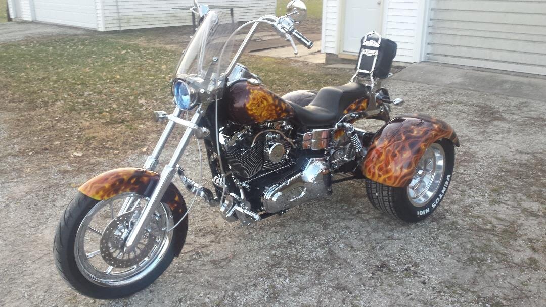

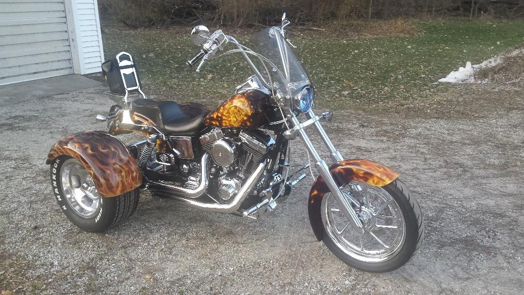

I went with the Frankenstein kit on my 04 Dyna Lowrider....loved the kit and was able to put it together myself(with a little help from a friend sliding the axle together) Didn't want a full body on the trike...more or less a "chopper" or "cruiser" type. Put a 4 degree rake on the front end and extended the front end a total of 6inches. Did this two years ago and couldn't be happier. They are great guys to work with. No welding or chopping up the swingarm. They sell one that you just bolt on. I went with their 38" wide kit and 265x50x15 tires on the rear. Handles great---had it up to 85-90 MPH and solid as a rock. Took a few trophies in the bike shows that I entered also. Always a head turner.
