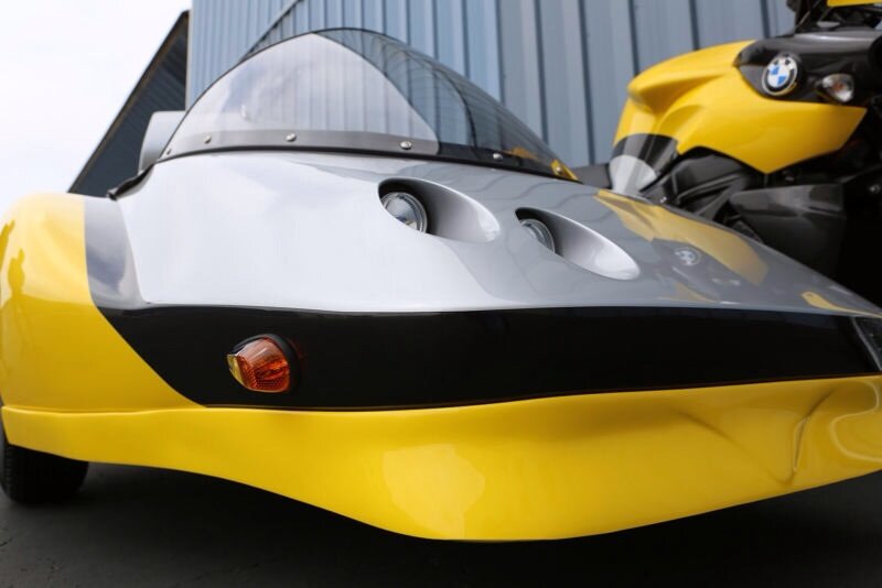

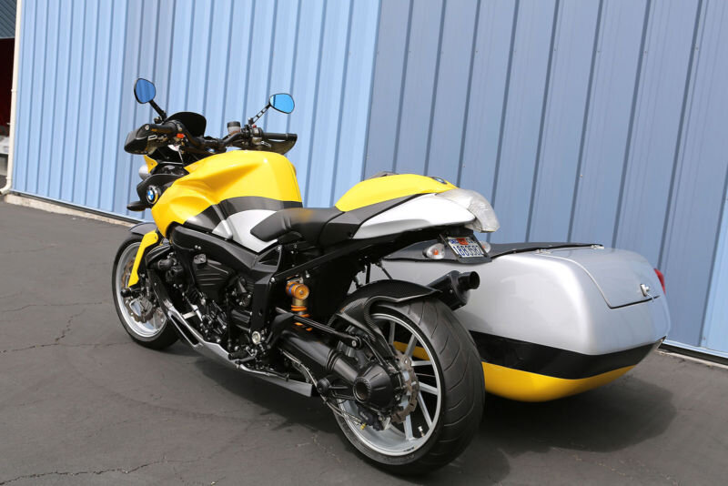

Hi guys, well here is my new sidecar, it's been a couple of weeks before I was able to go and pick it up. Mr Hannigan himself personally did the install on the sidecar, equipped with linked Brembo brakes and electronic trim. Rode from Ca to AZ and will probably get sent home now in the east coast. Great riding in AZ this time of the year. IMG_6115.JPGIMG_6109.JPGIMG_6104.JPGimage.jpg
Great looking rig! My friend has a Hannigan HP Suzuki Bandit with Bandito sidecar complete with hub centre steering and car wheels/tires all the way around. Looks like Hannigan left motorcycle tires on your set up. I would love to year what you think about the handling, especially with that fork set up!
The fornt suspension is stock except for the Ohlins upgrade setup front and rear. The BMW front Duolever is actually perfect for a sidecar similar to a Hossack front end. It has dynamics similar to earls front end found on many sidecar rigs. The bike has a pretty long wheel base which makes it perfect for a sidecar that tracks arrow straight and stable at hyper speeds. The handlebar has been modified to be wider which makes steering easy and no shimmies at all or head shakes. This bike has been dyno'd and tune to produces 173 hp at the rear wheels and over 130 Nm of torque. The sidecar is equipped with progressive coil over shocks and also the optional linked Brembo brakes with electronic trim adjustment on the left thumb for easy adjustments on the fly.
